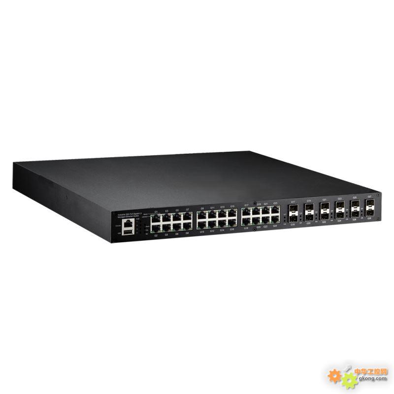

²úÆ·Ãû³Æ£º JetNetϵÁлú¼Üʽ¹¤Òµ½»»»»ú
ÐÍ ºÅ£º JetNet6828GF
Æ· ÅÆ£º о»Ýͨkorenix
JetNet 6828Gf¹¤Òµ¼¶»ú¼Üʽ28¿ÚȫǧÕ× L3Íø¹ÜÐÍÒÔÌ«Íø½»»»»ú
•  24¸ö100/1000Base-TXµç¿Ú£¬8¸ö100/1000 RJ-45/SFP combo¶Ë¿Ú£¬4¸öǧÕ×SFP¶Ë¿Ú
•  ¸ß¼¶ÍøÂ簲ȫ¹ÜÀí¹¦ÄÜ – DHCP Snooping, IP Source Guard, Dynamic ARP Inspection, Denial of Service (DoS)protection, L2/L3/L4 Access Control List (ACL)
•  ¸ß¼¶ÈßÓ๦ÄÜ – MSR, SuperChain, ITU-T G.8032 ERPS
•  Ö§³ÖUSB¹Ì¼þÉý¼¶ºÍÉèÖñ¸·Ý»¹Ô­¹¦ÄÜ
•  Ö§³ÖIEEE 1588v2 PTP¾«×¼Ê±ÖÓͬ²½£¨º¬HWʱ¼ä´Á£©
•  ÂÌÉ«½ÚÄÜģʽ
•  ÓѺõÄÓû§½çÃæºÍ×Ô¶¯¼ìË÷ÍØÆË½á¹¹Èí¼þ
•  ¸ôÀëÈßÓàµçÔ´£º24/48VDC »ò 110/220 VAC
•  Âú×ãEN50121-4£¬IEEE1613ºÍIEC61850-3±ê×¼
•  ¹¤×÷ζȣº-40 ~ 85C
ÐͺţºJetNet 6828Gf-AC / -2AC / -AC-DC24 / -2DC24 / -2DC48
