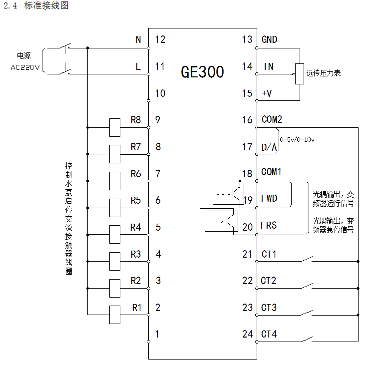

²úÆ·Ãû³Æ£º GE300BX΢»úºãѹ¸øË®¿ØÖÆÆ÷
ÐÍ ºÅ£º GE300BX
GE300ºãѹ¹©Ë®¿ØÖÆÆ÷£¨×î¶à¿É¿ØÖÆËĄ̈±Ã£©
1.1     ¿ØÖÆÆ÷ÌØµã
   ±¾²úÆ·ÊÇÓ¦¹ã´óÓû§µÄÒªÇó×îÐÂÍÆ³öµÄ¸ßÐÔÄÜ΢»ú¸øË®¿ØÖÆÆ÷¡£²ÉÓÃ¸ßÆ·
ÖÊÔª¼þ¡¢²ÄÁϼ°ÈÚºÏ×îеĿØÖƼ¼Êõ¶ø³É£»ºÍ±äƵÆ÷×éºÏÔÚÒ»Æð£¬¼´¿É¹¹³ÉÃñÓá¢
¹¤Òµ¡¢Ïû·ÀµÈÐÐÒµÊÊÓõÄ΢»ú±äƵµ÷ËÙºãѹ¹©Ë®ÏµÍ³¡£
l        ²ÉÓÃÄ£ºý¿ØÖÆÔ­Àí£¬×Ô¶¯ÓÅ»¯Ê±ÎÞÐèµ÷Õû¿ØÖÆÆ÷²ÎÊý£¬ÏìÓ¦¿ì¡¢¾«¶È¸ß¡¢±ÃÇÐ
»»Ê±¹ÜÍø³å»÷С¡£
l        ¾ß±¸×Ô¶¯¶¨Ê±»»±Ã£¬¶¨Ê±¿ª¹Ø»úÉèÖã¬Ìá¸ßË®±Ãƽ¾ùʹÓÃÊÙÃü¡£
l        ÏµÍ³ÌṩÐÝÃß¹¦ÄܽÚÄܹ¤×÷·½Ê½¡£
l        ÔÚѹÁ¦²»×ãÐèÒª¼Ó±Ãʱ£¬±äƵ±Ã½«×Ô¶¯½µËÙ£¬¼õÉÙÇл»³å»÷¡£
l        Ôö¼Ó¹øÂ¯²¹Ë®£¬Ð¹Ñ¹·§Ñ¹Á¦Çø¼ä¿ØÖÆÑ¡Ôñ¡£
l        ±äƵÆ÷¹ÊÕÏʱ£¬¿ÉÑ¡Ôñ×Ô¶¯×ªÈ빤ƵÔËÐС£
l        Ò»ÓÃÒ»±¸¡¢Ò»ÓÃÒ»²¹¡¢Á½±Ã¡¢Èý±Ã¡¢ËıÃÑ­»·ÈíÆðµÈ¹¦ÄÜ£¬ÄÜÂú×㲻ͬÓû§µÄ
ÐèÇó¡£
l        ¼ò»¯¼üÅ̲˵¥Ê½É趨ºÍµ÷Õû¹¤×÷״̬¡£
l        ²ÎÊýÔÚÏß±à³Ì£¬´ó´ó·½±ãʹÓá£
l        ²ÉÓÿª¹ØµçÔ´¹©µçÉè¼Æ£¬¾ßÓпíµçѹÊÊÓ÷¶Î§£¬¿¹¸ÉÈÅÄÜÁ¦Ç¿¡£
l        Æ÷¼þ²ÉÓÃÏȽøµÄSMT£¨±íÃæÌù×°£©¹¤ÒÕ£¬¿É¿¿ÐԸߡ£
l        ±£»¤¼°±¨¾¯¹¦ÄÜÆëÈ«£¬¾ßÓÐ±äÆµÆ÷¹ÊÕÏ£¬Ô¶´«Ñ¹Á¦±í¶ÏÏß¡¢¶Ì·
¹ÊÕÏ¡¢Ç·Ñ¹³¬Ê±¡¢µÍˮ뱨¾¯Ö¸Ê¾¡£
l        ÍêÉÆµÄÃÜÂ빦ÄÜ¡£

Êý×Ö¶Ë×Ó
CT1-CT4ÓëCM2
¹âñî¸ß×èÊäÈ룬ÑϽû½ÓÈëµçÔ´ÐźÅ
FWD BXÓëCM1
¹âñîÊä³ö£¬ÓÐÕý¸º¼«
R1-R8¼ÌµçÆ÷Êä³ö
3A/250V£¨AC£©»ò5A/30V£¨DC£©
Ä£Äâ¶Ë×Ó
D/AÓëCM2
Êä³ö0-5V 0-10V
INÓëGND
ÊäÈë0-2.5V 4-20mA
+2.5V
30mA

Ðͺ𢰲װºÍ½ÓÏß
2.1ÐͺÅ
l        Á½Ì¨±ÃÑ­»·ÈíÆðÐÍ£º               GE300B
l        Èý̨±ÃÑ­»·ÈíÆðÐÍ£º               GE300C
l        ËĄ̈±ÃÑ­»·ÈíÆðÐÍ£º               GE300D
l        Á½Ì¨±ÃÑ­»·ÈíÆðÐÍ£¨´øÐ¹Ñ¹¹¦ÄÜ£©£ºGE300BX
±¸×¢£ºÐͺÅÖк¬T£¬±íʾ´øÊ±¿Ø¹¦ÄÜ¡£
2.2       °²×°³ß´ç¼°ËµÃ÷
l        ÍâÐγߴ磺    ³¤×¿í×Éî=152×75×85
l        ×î´ó¿ª¿×³ß´ç£º³¤×¿í=152×75
±¾¿ØÖÆÆ÷²ÉÓÃÖ±²åʽ°²×°·½·¨£¬¿ØÖÆÆ÷´øÓлع³£¬¿ÉÖ±½Ó¿¨ÔÚÏäÌ忪¿×´¦¡£
