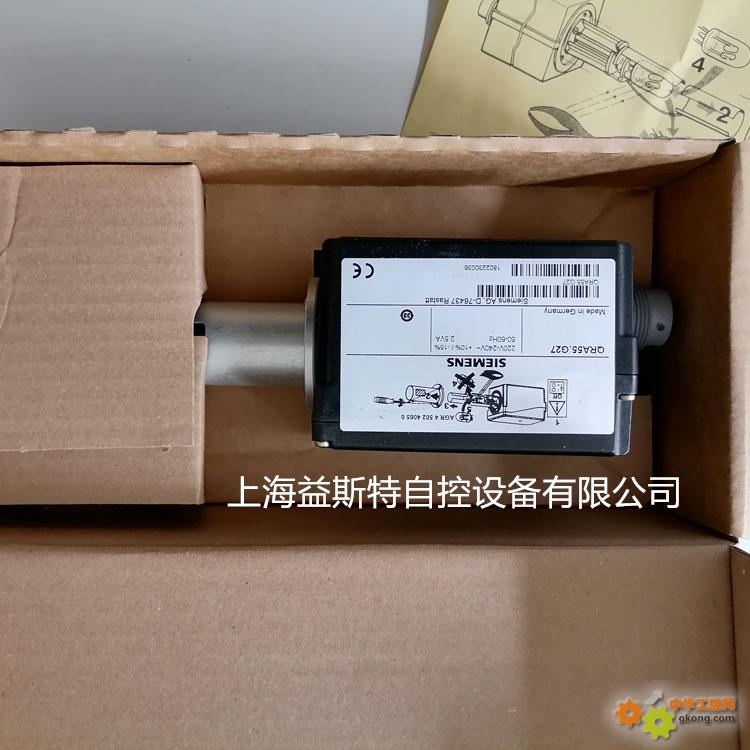

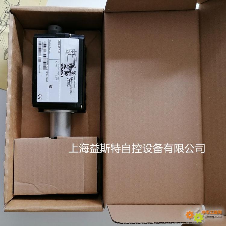

QRA53ºÍQRA55ϵÁж¼ÊÊÓÃÓÚ24СʱÁ¬ÐøÔËÐÐ
»ðÑæÌ½²âÆ÷ QRA5... ¹¹ÔìÉè¼ÆÈçÏ£º
̽²âÆ÷ UV µ¥ÔªÎ»ÓÚÒ»¸öÐýת¿ìÃŵĺóÃæ£¬Õâ¸ö¿ìÃŵÄλÖÃÔÚ±»·¨À¼Á¬½ÓÖÁÍâ¿ÇµÄ̽²âÆ÷¹ÜµÄǰĩ¶Ë´¦¡£ÓÐÒ»Ãæ
ʯӢ²£Á§´°±£»¤¹Ü×ӺͿìÃŲ»ÊÜÎÛ¹¸ËðÉË¡£Ì½²âÆ÷ÄÚ²¿µÄÂí´ïÓÃÒÔÇý¶¯ºÍ¿ØÖÆ¿ìÃÅ¡£
²úÆ·½éÉÜ£º
»ðÑæÌ½²âÆ÷ÓëÎ÷ÃÅ×ÓȼÉÕ¿ØÖÆÆ÷ÅäºÏʹÓã¬ÓÃÓÚÈ¼Æø»òȼÓÍ»ðÑæµÄ¼à²â¡£
»ðÑæÌ½²âÆ÷ÓÃÓÚ¼à²âÈ¼Æø»ðÑæ¡¢»ÆÉ«»òÀ¶É«È¼ÓÍȼÉÕ»ðÑæÒÔ¼°µã»ð»ð»¨µÄУ¶Ô¡£
ÕâÖÖÀàÐ͵ĻðÑæÌ½²âÆ÷¼à²âÈ¼Æø»òȼÓÍ»ðÑæ·Å³öµÄ UV ·øÉä²úÉúµÄ»ðÑæÐźš£
·øÉä̽²âÆ÷ÊÇÒ»¸ö´ø 2 ¸öµç¼«µÄ UV ¹âµç¹Ü£¬µ±Ëü±»¹âÆ×ÖÐ 190...270 nm ·¶Î§µÄ¹âÕÕÉä
ʱ±ã»áµãȼ£¬´Ó¶øÆô¶¯»ðÑæÌ½²âÆ÷µç·ÄڵĵçÁ÷¡£
UV ²»»á¶ÔȼÉÕÊÒÄÚׯÈȵÄÄÍ»ðש,ÈÕ¹â»òÕÕÃ÷¹âÏß²úÉú·´Ó¦¡£
²Î¿¼ÐͺŠ   ÁéÃô¶È    Ì½²âÆ÷¹Ü³¤¶È    ¹¤×÷µçѹ    UV¹Ü±àºÅ
QRA53.E27(QRA53.C27)    Õý³£    125mm    AC220-240V    ARG4 502 4065 7
QRA53.E17(QRA53.C17)    Õý³£    125mm    AC100-110V    ARG4 502 4065 7
QRA53.G27(QRA53.D27)    ¸ß    125mm    AC220-240V    ARG4 502 4065 7
QRA53.G17(QRA53.D17)    ¸ß    125mm    AC100-110V    ARG4 502 4065 7
QRA55.E27(QRA55.C27)    Õý³£    77mm    AC220-240V    ARG4 502 4065 7
QRA55.E17(QRA55.C17)    Õý³£    77mm    AC100-110V    ARG4 502 4065 7
QRA55.G27(QRA55.D27)    ¸ß    77mm    AC100-110V    ARG4 502 4065 7
QRA55.G17(QRA55.D17)    ¸ß    77mm    AC220-240V    ARG4 502 4065 7
