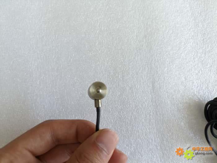

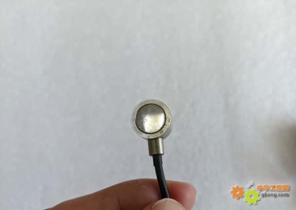

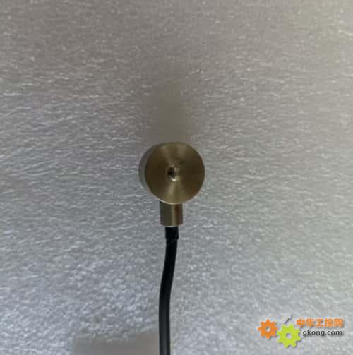

²úÆ·Ãû³Æ£º LZ-WXM22¸ß¾«¶ÈĤºÐʽ³ÆÖزâÁ¦Ñ¹Á¦´«¸ÐÆ÷
ÐÍ ºÅ£º LZ-WXM22
LZ-WXM22¸ß¾«¶ÈĤºÐʽ³ÆÖزâÁ¦Ñ¹Á¦´«¸ÐÆ÷¾ßÓÐʲôÐÔÄÜÌØµã£¿
1¡¢¸ß¾«¶È²âÁ¿£º¾­¹ýУ׼ºó£¬LZ-WXM22¸ß¾«¶ÈĤºÐʽ³ÆÖزâÁ¦Ñ¹Á¦´«¸ÐÆ÷Äܹ»ÊµÏָ߾«¶ÈµÄÖØÁ¿²âÁ¿¡£
2¡¢ÁéÃô¶È·´Ó¦ºÃ£º¶Ô΢СµÄÖØÁ¿±ä»¯Ò²ÄܲúÉúÃ÷ÏԵĵçÐźÅÊä³ö¡£
3¡¢¿¹Æ«ÔØÐÔÄÜÁ¦Ç¿£ºÓÉÓÚÆä½á¹¹Ð¡ÇÉÇҸ߶ȵͣ¬Òò´Ë¾ßÓнϺõĿ¹Æ«ÔØÐÔÄÜ¡£
4¡¢Ä͸¯Ê´Ð§¹ûÏÔÖø£ºÍ¨³£²ÉÓÃÈ«²»Ðâ¸Ö²ÄÖÊ£¬¾ßÓÐÁ¼ºÃµÄÄ͸¯Ê´ÐÔÄÜ¡£
LZ-WXM22¸ß¾«¶ÈĤºÐʽ³ÆÖزâÁ¦Ñ¹Á¦´«¸ÐÆ÷Ó¦ÓÃÔÚÄÄЩÁìÓò£¿
LZ-WXM22¸ß¾«¶ÈĤºÐʽ³ÆÖزâÁ¦Ñ¹Á¦´«¸ÐÆ÷¹ã·ºÓ¦ÓÃÓÚÆ½Ì¨³Æ¡¢Æû³µºâ¡¢¹ìµÀºâ¼°×Ô¶¯»¯²â¿ØÁìÓò¡£ÔÚ¹¤ÒµÉú²ú¹ý³ÌÖУ¬Ëü³£ÓÃÓÚÔ­²ÄÁϳÆÖØ¡¢Éú²ú¹ý³ÌÖеÄÖÊÁ¿¿ØÖƵȻ·½Ú¡£´ËÍ⣬ÔÚÒ½ÁƱ£½¡ÁìÓò£¬Ä¤ºÐʽ³ÆÖØ´«¸ÐÆ÷Ò²ÓÃÓÚ¼à²â»¼ÕßµÄÌåÖØ±ä»¯µÈ¡£
LZ-WXM22¸ß¾«¶ÈĤºÐʽ³ÆÖزâÁ¦Ñ¹Á¦´«¸ÐÆ÷¼¼Êõ²ÎÊý
Á¿³Ì  0¡«2t
ÁãµãÊä³ö  ≤±1%F.S
ÁéÃô¶È  0.7¡«1.5mV/V
·ÇÏßÐÔ  ≤±0.5%F.S
Öͺó  ≤±0.5%F.S
ÖØ¸´ÐÔ  ≤±0.5%F.S
Èä±ä  ≤±0.5%F.S/30min
ÁãµãÎÂ¶ÈÆ¯ÒÆ  ≤±0.05£¥F.S/10¡æ
ÁéÃô¶ÈÎÂ¶ÈÆ¯ÒÆ  ≤±0.05£¥F.S/10¡æ
ʹÓÃζȷ¶Î§  -20¡æ¡«+60¡æ
ÊäÈë×迹  380±30Ω/730±30Ω
Êä³ö×迹  350±2Ω/700±3Ω
¾øÔµµç×è  ≥5000MΩ/100VDC
°²È«¹ýÔØ  120£¥F.S
¹©Çŵçѹ  5¡«12VDC£¨ÍƼö10VDC£©
²ÄÖÊ  ²»Ðâ¸Ö
½ÓÏß·½Ê½  ºìÉ«£ºµçÔ´+£¨E+£©¡¡ºÚÉ«£ºµçÔ´-£¨E-£©
 ÂÌÉ«£ºÊä³ö+£¨S+£©¡¡°×É«£ºÊä³ö-£¨S-£©
