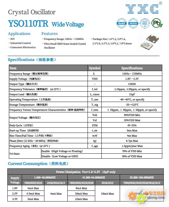

²úÆ·Ãû³Æ£º ¾§ÕñÔÚ¹¦·Å»úÖеÄ×÷ÓÃ
ÐÍ ºÅ£º YSO110TR
Æ· ÅÆ£º YXC

ÔÚÊý×ÖÒôƵÖУ¬Ê±ÖÓÆµÂʵÄÏàλÔëÉù»áÓ°Ïì DAC µÄ¶¶¶¯¹¦ÄÜ£¬²¢µ¼ÖÂÉùÔ´µÄ¶ñ»¯£¬ÎªÁ˾«È·µØÔÙÏָ߷ֱæÂÊÉùÔ´£¬Òò´Ë£¬²ÉÑùƵÂÊÓÉÒôƵÉ豸ÍâÖõÄʯӢ¾§ÌåÕñµ´Æ÷ÌṩµÄÒôƵÖ÷ʱÖÓÐźš£
³£¼ûµÄ¾§ÕñƵÂÊÓУº11.2896MHZ¡¢12.288MHZ¡¢22.5792MHZ¡¢24.576MHZ¡¢45.1584MHZ¡¢49.152MHZ¡£
ÍÆ¼öÑïÐ˿Ƽ¼£¨YXC£©YSO110TRϵÁУ¬ÆµÂÊÎȶ¨ÐÔ±10ppm£¬ÆµÂÊ·¶Î§1-125MHZ£¬¿É¼æÈݶà¸öµçѹ£º1.8-3.3V£¬¹¤×÷ζÈ-40~£«85°£¬ÏµÁйæ¸ñÊéÈçÏ£º
