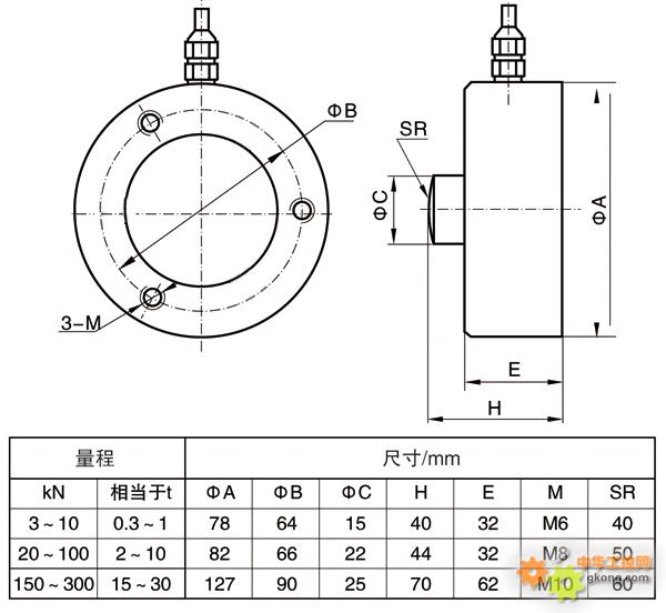

²úÆ·Ãû³Æ£º NTJH-14ĤºÏ´«¸ÐÆ÷ ²»Ðâ¸Ö³ÆÖØ´«¸ÐÆ÷
ÐÍ ºÅ£º NTJH-14
NTJH-14ĤºÏ³ÆÖØ´«¸ÐÆ÷£¬ÓÖ½ÐĤºÐ³ÆÖزâÁ¦´«¸ÐÆ÷¡¢Ä¤ºÏÖØÁ¿´«¸ÐÆ÷¡¢Ä¤ºÏºÉÖØ´«¸ÐÆ÷¡¢Ä¤ºÏ²âÁ¦´«¸ÐÆ÷¡¢Ä¤ºÏѹÁ¦´«¸ÐÆ÷¡£NTJH-14ĤºÏ³ÆÖØ´«¸ÐÆ÷£¬²ÉÓò»Ðâ¸Ö²ÄÖÊ£¬¿¹Æ«ÔØÄÜÁ¦Ç¿£¬Ë«ÖØÃܷ⣬ÊÊÓÃÓÚ¸÷ÖÖ¶ñÁÓ»·¾³ÏÂÁ¦ÖµµÄ¼ì²â¡£
¼¼Êõ²ÎÊý
¶î¶¨Ôغɣº 3,5,10,20,30,50,100,150,200,300(kN)
×ۺϾ«¶È£º 0.03~0.1%F.S
ÁéÃô¶È£º 2.0mV/V
Èä±ä£º ±0.03%F·S/30min
ÁãµãÊä³ö£º ±1%F·S
ÁãµãζÈÓ°Ï죺 ±0.03%F·S/10¡æ
Êä³öζÈÓ°Ï죺 ±0.03%F·S/10¡æ
¹¤×÷ζȣº -20¡æ~+65¡æ
ÊäÈë×迹£º 380±30Ω»ò750±50Ω
Êä³ö×迹£º 350±3Ω»ò700±5Ω
¾øÔµµç×裺 >5000 MΩ
°²È«¹ýÔØ£º 150%F·S
¹©Çŵçѹ£º ½¨Òé 10V DC
²ÄÖÊ£º ²»Ðâ¸Ö
´«¸ÐÆ÷½ÓÏß·½Ê½£ºÊäÈë+:ºì  ÊäÈë-:ºÚ  Êä³ö+:ÂÌ  Êä³ö-:°×
²úÆ·ÍâÐγߴç
