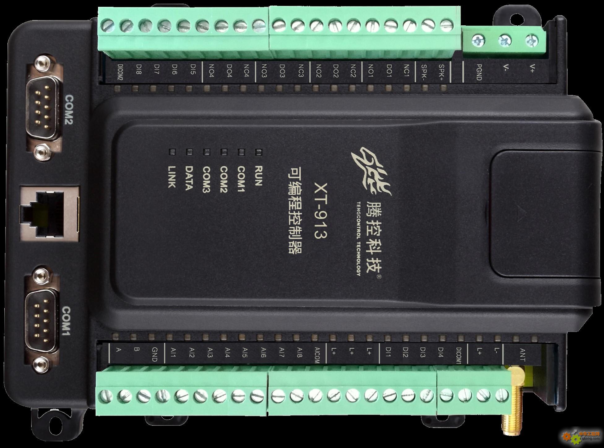

XT-913¿É±à³Ì¿ØÖÆÆ÷ÊÇÎÒ¹«Ë¾XT-900ϵÁÐPLCÆäÖÐÒ»¿î²úÆ·¡£Ê¹ÓÃCortex A7´¦ÀíÆ÷£¬ÄÚÖÃGPU£¬×î¸ßƵÂÊ1GHZ£¬ÅäÓÐ128M DDR3 RAM¡¢8G¹¤Òµ¼¶FLASH´æ´¢Æ÷¡£Ç¶ÈëʽʵʱLinux²Ù×÷ϵͳ£¬Ê¹Óõ¹ú¿ÆÎ¬MultiprogÈí¼þ±à³Ì£¬Í¨¹ýÒÔÌ«ÍøÏÂÔØ³ÌÐò¡£
XT-913ÓÐ3·Íⲿ´®ÐÐͨѶ¿Ú¿É±à³Ì×öΪÖ÷Õ¾£¬»¹ÓÐÁ½Â·ÄÚ²¿Ê¹ÓõĴ®¿Ú£¬ÆäÖÐ1·×÷ΪLinuxÖÕ¶Ë£¬1·ÓÃÓÚÁ¬½ÓZigbeeÄ£¿é¡£
ͨ¹ýCPUµÄ½Ó¿Ú£¬ÍâÀ©RTCʵʱоƬºÍ32KµÄRAMоƬ£¬ÊµÊ±Ê±ÖÓºÍRAMͨ¹ý±¾»úÄÚÖõĿɳäµçʽť¿Ûµç³Ø¹©µçʵÏÖµôµçÊý¾Ý±£³Ö¡£XT-913¼¯³É8·DI¡¢4·¼ÌµçÆ÷£¨³£¿ªÓë³£±Õ£©¡¢8·AI¡¢ÓïÒôÊä³ö¡¢24VÖ±Á÷Êä³öÓÚÒ»Ì壬ÄÚÖÃWEB·þÎñÆ÷ºÍSQLiteÊý¾Ý¿â·þÎñÆ÷£¬ÏµÍ³¿ÉÒÔͨ¹ýWEBÉý¼¶£¬ÊÊÓÃÓÚÓÍÌïÊÒÄÚºÍÒ°Íâ¸÷ÖÖÊý¾Ý²É¼¯¡¢¿ØÖƳ¡ºÏ¡£
Ö÷Òª¹¦ÄÜ
Ô¶³ÌÆôÍ£¾®¡¢¼ä³é¿ØÖÆÓïÑÔ²¥±¨£ºÊÕµ½Êý¾ÝÖÐÐĵÄÃüÁîºóÓïÑÔ²¥±¨ÔÙÆô¾®»òÍ£³éÓÍ»ú¡£
»¹ÓгéÓÍ»úÔËÐÐģʽÏÖ³¡²éѯ¹¦ÄÜ£¬³éÓÍ»ú״̬¼à²âºÍ¿ª»úʱÂʼà²â¹¦ÄÜ¡£
Êý¾Ý²É¼¯´æ´¢£ºÔغɡ¢Î»ÒÆ¡¢Ñ¹Á¦ÊµÊ±²É¼¯£¬µçÁ¿²ÎÊý²É¼¯£¬¹¦Í¼¡¢¹¦ÂÊͼÉú³É£¬ÀúÊ·¹¦Í¼¡¢Òì³£¹¦Í¼¡¢µç²ÎÊý¾Ý¡¢¹ÊÕÏÐÅÏ¢µÄ±¾µØ´æ´¢£¬Ö§³Ö¶¯ÒºÃæ¡¢º¬Ë®·ÖÎöÒǵÈÉ豸¡£
Êý¾Ý´«Ê䣺¾®¿ÚRTUÓë¾®³¡Ö÷RTUÖ®¼äÊý¾ÝͨѶ£¬Ö§³ÖRS485¡¢ZigBeeÊý¾Ý´«Êä¡£
µç»ú±£»¤£ºÊµÊ±¼à²â³éÓÍ»úµç²Î£¬¾ß±¸¹ýÁ÷¡¢¹ýѹ¡¢È±Ïà±£»¤¹¦ÄÜ¡£
¼ä³é¿ØÖÆ£ºÖ§³Ö¼ä³éģʽѡÔñ¡¢¶àÖÖ¼ä³éģʽ¿ØÖƹ¦ÄÜ¡£
¹ÊÕÏÕï¶Ï£ºÖ§³ÖRTU×ÔÉí¹ÊÕÏÕï¶Ï¡¢ÒDZí¹ÊÕÏÕï¶Ï¡¢µç»ú¹ÊÕÏÕï¶Ï¡£
IOÊýÁ¿
±¾»úÊý×ÖÁ¿ÊäÈë
8
¹âñî¸ôÀëÊäÈë
±¾»úÊý×ÖÁ¿Êä³ö
4
ÿ·º¬³£¿ª¡¢³£±Õ¼ÌµçÆ÷´¥µã
±¾»úÄ£ÄâÁ¿ÊäÈë
8
0-20mA¡¢0-5V
I/O״ָ̬ʾµÆ
44¸ö
²¿·ÖδÓÃ
¿É±à³ÌÓïÒôÊä³ö
1
ÄÚÖÃÉù¿¨£¬¹¦ÂÊ·Å´óÆ÷£¬6-8Å·ÑïÉùÆ÷£¬×î´ó¹¦ÂÊ25W
ÒôÁ¿¿ØÖÆ
±¾²úÆ·²ÉÓÃ1D-CNNÄ£ÐÍ£¬Ê¹ÓÃÒѾ­ÑµÁ·ºÃµÄ²ÎÊý£¬Í¨¹ýʾ¹¦Í¼ÇúÏߺ͹¦ÂÊÇúÏߣ¬¿ÉÒÔʶ±ðÓ;®³£¼û¹¤×÷״̬£¬°üÀ¨µ«²»ÏÞÓÚ
Õý³£¹¤×÷£¬¹©Òº²»×㣬°éÆøÓ°Ïì£¬ÆøËø£¬Åö±Ã£¬·§¹Ø±ÕÑÓ³Ù£¬ÖùÈûÍѳö£¬Óζ¯·§Â©Ê§£¬¹Ì¶¨·§Â©Ê§£¬Æ¤´ø¶Ï£¬Æ¤´ø´ò»¬¡£
¹¦Äܲ»¶Ï¸üÐÂÖУ¬¾´Çë¹Ø×¢ËµÃ÷Êé¸üС£
