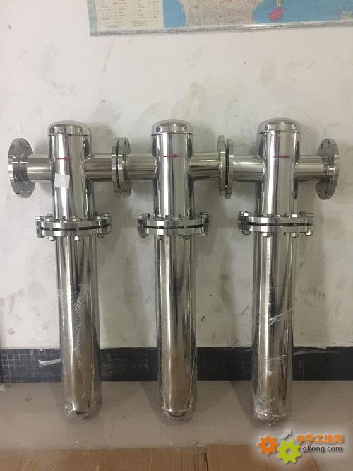

ÎÒ˾רҵÉú²ú¾ÈÉú²Õ¾«ÃܹýÂËÆ÷£¬¾ÈÉú²ÕÏûÒôÆ÷£¬¾®Ï±ÜÄÑíÏÊÒ¼õѹ·§ £¬ ¾ÈÉú²Õ²»Ðâ¸Ö¾«ÃܹýÂËÆ÷£¬±ÜÄÑíÏÊÒÑõÆø¹©Ó¦×Ô¿ØÏµÍ³¡¡
Ò».É豸˵Ã÷
±ÜÄÑíÏÊÒÄÚ²¿ÉèÖþßÓÐÏò±ÜÏÕÈËÔ±ÌṩÑõÆøÒÔ±£Ö¤±ÜÏÕÈËÔ±Äܹ»Î¬³ÖÕý³£ºôÎüµÄ¹©Ñõ×°Ö᣹©Ñõ×°ÖñØÐëÂú×㣺
£¨1£©±ÜÏÕÈËÔ±ÔÚ±ÜÄÑíÏÊÒµÄÉú´æÊÒÄÚÄܹ»ºôÎüµ½´¿¾»µÄÑõÆø£¬ÑõÆøÅ¨¶ÈÔÚ18.5%¡«22.0%£»
£¨2£©ÑõÆø¹©¸øÁ¿¼°ÑõÆøÅ¨¶È±ØÐëÂú×ãÈËÌåºôÎüÉúÀíÌØµã£»
£¨3£©ÑõÆø¹©¸øÊ±¼ä±ØÐëÂú×ã¶î¶¨ÈËÊýʱ²»ÉÙÓÚ96СʱµÄÉú´æÊ±¼ä£»
£¨4£©¹©Ñõ×°ÖÃÔÚ¾®ÏÂÌØÊâÌõ¼þϲ»ÊÜ»·¾³Ó°Ï죬±£Ö¤Äܹ»¼°Ê±¡¢¿É¿¿¹©Ñõ²¢²»»á´æÔÚ²»°²È«Òþ»¼¡£

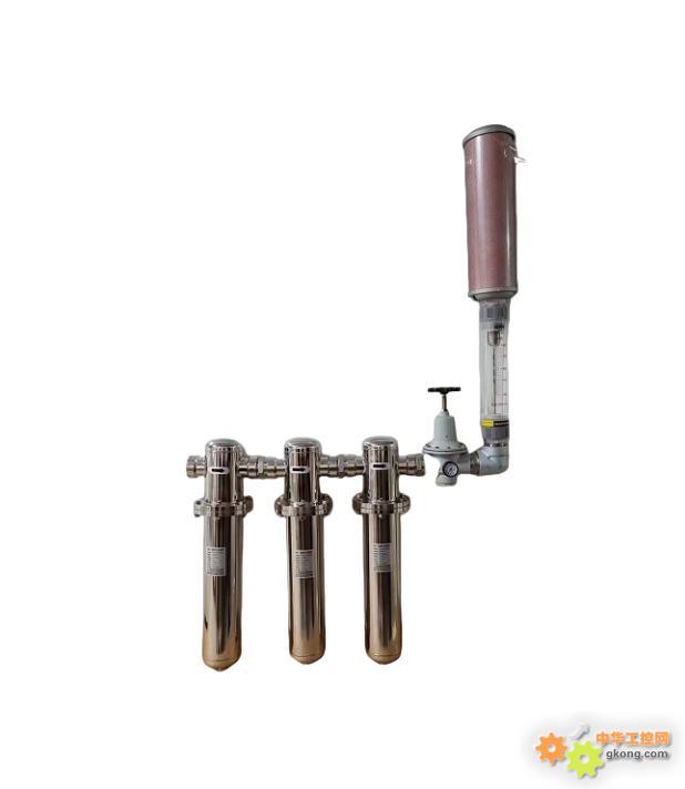

£¨5£©Ñ¹·çϵͳ¹©Ñõ×°ÖÃÀûÓÃíÏÊÒǰԤÂñµÄѹ·ç¹Ü·×÷ÎªÆøÔ´£¬¾­¹ý·§ÃźóÏȽøÈë¹ý¶É²ÕÄÚÉèÖõÄË®¡¢»Ò³¾¡¢Ó͵ÄÈý¼¶¹ýÂË£¬È»ºó¾­¹ýÔ¤ÏÈÉèÖõļõѹÆ÷¡¢¡¢¹Ü·½øÈëÆøÌåÊä³ö¶Ë£¬´Ó¶ø×ªµ½Ã¿ÈËÊÖÖеĺôÎüÃæÕÖÖУ¬Îª±ÜÄÑËùÄÚ±ÜÏÕÈËÔ±Ìṩ¸ü¼ÓÐÂÏÊ¡¢ÊæÊÊµÄ¿ÕÆø¡£
¶þ.¼¼Êõ²ÎÊý
£¨1£©Ñ¡ÓÃµÄ¿ÕÆø¹ýÂËÆ÷£¬Á÷Á¿·ûºÏÿÈËÿ·ÖÖÓ0.3m3µÄѹ·ç¹©ÆøÒªÇó
£¨2£©Ñ¡ÓÃµÄÆøÌå¼õѹÆ÷£¬Âú×ãÿÈËÿ·ÖÖÓ0.3m3µÄÁ÷Á¿ÒªÇ󣬿ɵ÷ѹÁ¦0.1-0.3MPa
£¨3£©Ñ¡ÓõÄÏûÒôÆ÷£¬¿É½«Ñ¹·çÔëÒô½«ÖÁ70dBÒ»ÏÂ
£¨4£©Ñ¹·ç¹ÜµÀ¹Ü¾¶£¬Âú×ã¹©ÆøÁ¿ÒªÇó
£¨5£©ÕûÌåͨ¹ý0.9MPaµÄµªÆøÊÔѹ£¬·ûºÏÆøÃÜÐÔÊÔÑéÒªÇ󣬲ÉÓÃ1.75MPaˮѹÊÔÑ飬·ûºÏÕûÌå¹Ü·µÄÇ¿¶ÈÒªÇó
Èý.É豸Çåµ¥
£¨1£©Èý¼¶¹ýÂËÆ÷£º1Ì×
£¨2£©µ÷ѹ·§£º1Ö»
£¨3£©ÏûÒôÆ÷£º1Ö»
£¨4£©Á÷Á¿¼Æ£º1Ö»£¨¿ÉÑ¡Å䣬Âú×ãÿÈËÿ·ÖÖÓ0.3m3µÄÁ÷Á¿Á¿³ÌÒªÇó£©
£¨5£©¹Ü½Ó¼þ£º1Ì×
