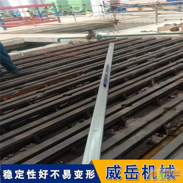

²ÉÓøßÇ¿¶ÈÖýÌú HT200-300 ÖÆÔ죬¹¤×÷ÃæÓ²¶È´ï HB170-240£¬¾­È˹¤»Ø»ð´¦Àíºó£¬¾«¶ÈÎȶ¨ÐÔÇ¿£¬ÄÍÄ¥ÐÔÄÜÓÅÒì¡£
Áé»îÆ´½ÓÓë³É±¾ÓÅÊÆ×÷Ϊ¹¤ÒµÖв»¿ÉÉÙµÄÉ豸£¬TÐͲÛÖýÌúµØ¹ì¿Éͨ¹ýÆ´½ÓÐγɴóÐͳÐÔØÆ½Ì¨£¬ÓÈÆäÊÊÓÃÓÚÌå»ýÅÓ´óµÄ»úеÉ豸¡£ÕâÖÖÉè¼Æ²»½ö½ÚÊ¡²ÄÁϳɱ¾£¬»¹ÄܼõÉÙ¿Õ¼äÕ¼Óã¬ÔÚµ÷ÊÔ¡¢ÊÔÑé¡¢¼ì²â¡¢×°ÅäµÈ³¡¾°Öб¸ÊÜÇàíù¡£
¶¨ÖÆ»¯Éú²ú¿É¸ù¾ÝÓû§Í¼Ö½»òË«·½É̶¨µÄ¹æ¸ñ¼Ó¹¤Éú²ú£¬Âú×㲻ͬ³¡¾°ÏµÄʹÓÃÐèÇó¡£
