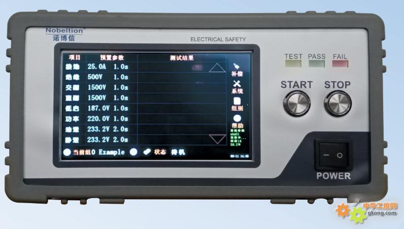

²úÆ·Ãû³Æ£º ŵ²©ÐŰ²¹æ×ۺϷÖÎöÒÇ NBX1540£¨ÎåºÏÒ»£©
ÐÍ ºÅ£º NBX1540
̨ʽ°²¹æ×ۺϷÖÎöÒÇ NBX1540£¨ÎåºÏÒ»£©
²úÆ·¼ò½é
̨ʽ°²¹æ·ÖÎöÒDzÉÓô¥¿ØÆÁÉè¼Æ£¬²Ù×÷¼ò±ã£¬ÏÔʾֱ¹Û£»¹¦Äܵ緸߶ȼ¯³É£¬ÊµÏÖÄ£¿é»¯ºÍ¹ÊÕÏ×ÔÎÒÕï¶Ï¹¦ÄÜ£¬ÊÛºó±ã½Ý£»¸Ã²úÆ·¹¦ÄÜÍ걸£¬¾«¶ÈÒµÄÚ×î¸ß£¬¸ü·ûºÏ±ê×¼ºÍ·¨¹æÒªÇó£»²âÊÔÊý¾Ý±¾»ú´æ´¢£¬¿Éͨ¹ýWiFiͨѶºÍÊÖ»úAPPµ¼³ö¡£ÓÉÓÚ²âÊÔÔËÐй¦ÂÊ¡¢µÍѹÆô¶¯ºÍ¶¯Ì¬Ð¹Â©µÈÏîĿʱ£¬±»²âÆ·ÐèÒª²»Í¬µÄµçѹÔËÐÐÖвâÊÔ£¬ËùÒÔͨ³£ÐèÒªÅäÖÃŵ²©ÐŹ«Ë¾±äƵµçÔ´ÅäºÏ²âÊÔ¡£Åµ²©ÐŹ«Ë¾°²¹æ·ÖÎöÒÇ»¹ÄÚÖÃÖ÷Á÷±äƵµçÔ´µÄͨѶЭÒ飬Óû§Ò²¿ÉÒÔÖ±½ÓʹÓÃÒÑÓÐÆäËûµçÔ´¡£
²úÆ·ÓÅÊÆ
(1)Ìå»ýСÇÉ£ºÕû»ú³ß´ç132×284×470£¨mm£©£¬3U¸ß¶È£¬18KgÖØÁ¿¡£
(2)¹¦ÄÜÆëÈ«£º¿É¸ù¾ÝÐèÇó×ÔÐÐÑ¡Ôñ¡£
(3)¸ß¾«¶È£º°²¹æÏîÄ¿²âÊÔ¾«¶È1%£¬¹¦ÂÊÀà²âÊÔ¾«¶È0.2%£»
(4)Ëٶȿ죺Çл»ËÙ¶ÈСÓÚ0.1S£¬¾ßÓв¢ÐвâÊÔ¹¦ÄÜ£¨±êÅ䣺½ÓµØ+ÄÍѹ£¬ÆäËû¿ÉÑ¡Å䣩¡£
(5)¿íÁ¿³Ì£º¾øÔµµç×è²âÊÔµçѹ3000V£¨¿ÉÑ¡6000V£©£¬²âÊÔ·¶Î§´ï100GΩ£»
(6)¸üºÏ¹æ£ºÄÍѹÈÝÁ¿125VA£¨5KV/25mA£©£»Ð¹Â©µçÁ÷ÄÚÖÃ6ÖÖÈËÌåÍøÂ磻
(7)¶À´´ÊµÓù¦ÄÜ£ºË«¼üģʽÆô¶¯£¬¿É¿ì½ÝÇл»²âÊÔ×飻֧³ÖÊä³öµçѹ»ºÉý¹¦ÄÜ£¬Âú×ãµÆ¾ß»ò¿ª¹ØµçÔ´µÈÌØÊâ²âÊÔÐèÇó¡£
(8£©ÐÅÏ¢»¯£º²âÊÔÊý¾Ý±¾»ú´æ´¢£¬¿Éʵʱµ¼³ö£»Ö±½ÓÁ¬½ÓÌõÂëɨÃèÒÇ£¬¾ß±¸Ô¶³ÌÉý¼¶ºÍÔ¶³ÌÕï¶Ï¹¦ÄÜ¡£
(9)¸ü°²È«£ºÈ«ÃæµÄ±£»¤¹¦ÄÜ£»
(10)ÒײÙ×÷ʹÓÃ:Ë÷ÒýʽÉèÖýçÃæ£¬Ê¹Óñã½Ý£»°ïÖúÐÅÏ¢·á¸»£¬·½±ãÅàѵÉϸڣ»¾ß±¸¹ÜÀíÔ±ºÍ²âÊÔÔ±Á½ÖÖģʽ£»²ÉÓþÀ´íʽ½Ó²å¼þ£¬ÎÞÐè°²×°µ÷ÊÔ¡£
(11)Ò×ά»¤:ÅŹʼòµ¥¿ì½Ý£¬½â¾öÊÛºóÄÑÌ⣻¹ÊÕÏ×ÔÕ﹦ÄÜ¡£
