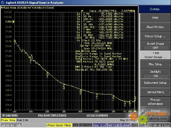

实测数据:
RMS Jitter 80fs @ 156.25MHz
 (12kHz - 20MHz)
