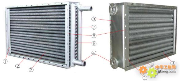

2.É豸½á¹¹
ÈçÏÂͼËùʾ£¬É¢ÈÈÆ÷ÊÇÓɵ²·ç°å¡¢Á¬½Ó°å¡¢»»Èȹܡ¢½Ó¿Ú¡¢ÍäÍ·¡¢¹Ü°å¡¢¼¯¹ÜºÍ¼¯Ïä×é³É
¢Ùµ²·ç°å¡¢¢ÚÁ¬½Ó°å¡¢¢Û»»Èȹܡ¢¢Ü½Ó¿Ú¡¢¢ÝÍäÍ·¡¢¢Þ¹Ü°å¡¢¢ß¼¯¹Ü¡¢¢à¼¯Ïä
