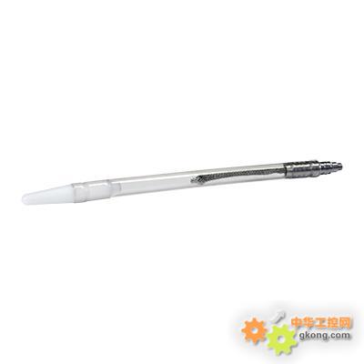

²úÆ·Ãû³Æ£º PCBˮϱ¬Õ¨ÊÔÑé³å»÷ѹÁ¦´«¸ÐÆ÷138A05
ÐÍ ºÅ£º 138A05
µçÆøÊ¯ ICP® ˮϱ¬Õ¨Ñ¹Á¦´«¸ÐÆ÷£¬
³¤¶È 7.6 Ó¢´ç£¬Á¿³Ì 5000 psi£¬ÁéÃô¶È 1 mV/psi
²âÁ¿·¶Î§£º5000 psi£¨34475 kPa£©
ÁéÃô¶È£º(±15%) 1.0 mV/psi£¨0.15 mV/kPa£©
µÍƵÏìÓ¦£º(-5%) 1.7 Hz
гÕñƵÂÊ£º≥1000 kHz
µçÆø½ÓÍ·£º10‑32
ͬÖá²å×ù
ÖØÁ¿£º0.75 °»Ë¾£¨21.0 ¿Ë£©
 ÐÔÄÜÖ¸±ê
Êä³ö ±5V ʱ²âÁ¿·¶Î§£º5000 psi£¨34475 kPa£© Êä³ö ±10V ʱÓÐЧ³¬Á¿³Ì£º10000 psi£¨68950 kPa£© ÁéÃô¶È(±15 %)£º1.0 mV/psi£¨0.15 mV/kPa£© ×î´óÄÍѹ£º50000 psi£¨344750 kPa£© ·Ö±æÂÊ£º0.1 psi£¨0.7 kPa£© гÕñƵÂÊ£º≥1000 kHz ÉÏÉýʱ¼ä£¨·´É䲨£©£º≤1.5 µs µÍƵÏìÓ¦£¨-5%£©£º1.7 Hz ·ÇÏßÐÔ¶È£º≤2.0 % ÂúÁ¿³Ì
»·¾³²ÎÊý
¹¤×÷ζȷ¶Î§£º-10¡«+100 °F£¨-23¡«+37.8 °C£© ×î´ó³å»÷£º20000 g ·åÖµ£¨196140 m/s² ·åÖµ£©
µçÆø²ÎÊý
ÕýѹÁ¦Êä³ö¼«ÐÔ£ºÕý¼« ·Åµçʱ¼ä³£Êý£¨ÊÒΣ©£º≥0.3 Ãë ¼¤Àøµçѹ£º20¡«30 VDC ºãÁ÷¼¤Àø£º2¡«20 mA Êä³ö×迹£º≤100 Ω Êä³öÆ«Öõçѹ£º8¡«14 VDC
ÎïÀí½á¹¹
´«¸ÐÔª¼þ£ºµçÆøÊ¯ Íâ¿Ç²ÄÁÏ£º²»Ðâ¸Ö µçÆø½ÓÍ·£º10‑32 ͬÖá²å×ù ÖØÁ¿£º0.75 oz£¨21.0 g£©
