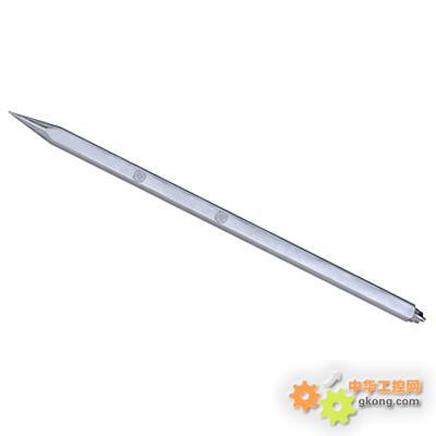

²úÆ·Ãû³Æ£º ×ÔÓɳ¡ICP³å»÷²¨Ñ¹Á¦±Êʽ̽ͷ´«¸ÐÆ÷
ÐÍ ºÅ£º 137B25
ʯӢ²ÄÖÊ¡¢×ÔÓɳ¡ÐÍ¡¢ICP® ³å»÷²¨Ñ¹Á¦±Êʽ̽ͷ£¬Á¿³Ì 50 psi£¬ÁéÃô¶È 100 mV/psi£¬4 ÕëÁ¬½ÓÆ÷£¬¾ß±¸Á½Â·Êä³ö£¬ÓÃÓÚ²¨´ïʱ¼ä£¨TOA£©²âÁ¿ ±¾²úƷΪ˫´«¸ÐÔª¼þ±Êʽ̽ͷ£¬¿Éͬʱ²âÁ¿²¨´ïʱ¼ä£¨ÓÃÓÚ¼ÆËã³å»÷²¨ËÙ¶È£©ÓëѹÁ¦Ê±Óò²¨ÐΣ¨ÓÃÓÚ×ܳåÁ¿²âÁ¿£©£¬¼¯Á½ÖÖ¹¦ÄÜÓÚÒ»Ìå¡£ ²âÁ¿·¶Î§£º50 psi£¨345 kPa£© ÁéÃô¶È£º(±15%) 100 mV/psi£¨14.5 mV/kPa£© гÕñƵÂÊ£º≥400 kHz µçÆøÁ¬½ÓÆ÷£º4 Õë½ÓÍ· ÖØÁ¿£º16.1 °»Ë¾£¨456 ¿Ë£© ÐÔÄÜÖ¸±ê Êä³ö ±5V ʱ²âÁ¿·¶Î§£º50 psi£¨345 kPa£© Êä³ö ±10V ʱÓÐЧ³¬Á¿³Ì£º100 psi£¨690 kPa£© ÁéÃô¶È(±15 %)£º100 mV/psi£¨14.5 mV/kPa£© ×î´óÄÍѹ£º1 kpsi£¨6895 kPa£© ·Ö±æÂÊ£º10 mpsi£¨0.069 kPa£© гÕñƵÂÊ£º≥400 kHz ÉÏÉýʱ¼ä£¨ÈëÉ䲨£©£º≤6.5 µs ·ÇÏßÐÔ¶È£º≤1.0 % ÂúÁ¿³Ì »·¾³²ÎÊý ¹¤×÷ζȷ¶Î§£º-100¡«+275 °F£¨-73¡«+135 °C£© ÁéÃô¶ÈζÈϵÊý£º≤0.05 %/°F£¨≤0.090 %/°C£© µçÆø²ÎÊý ·Åµçʱ¼ä³£Êý£¨ÊÒΣ©£º≥0.3 Ãë ¼¤Àøµçѹ£º22¡«30 VDC ºãÁ÷¼¤Àø£º2¡«20 mA Êä³ö×迹£º≤100 Ω Êä³öÆ«Öõçѹ£º8¡«15 VDC ÎïÀí½á¹¹ ´«¸Ð·½Ê½£ºÑ¹Ëõʽ ´«¸ÐÔª¼þ£ºÊ¯Ó¢ Íâ¿Ç²ÄÁÏ£ºÂÁºÏ½ð ĤƬ£ºÒòÍߺϽð Ãܷⷽʽ£º»·ÑõÊ÷Ö¬ÃÜ·â µçÆø½ÓÍ·£º4 ÕëÁ¬½ÓÆ÷ ÖØÁ¿£º16.1 oz£¨456 g£©
