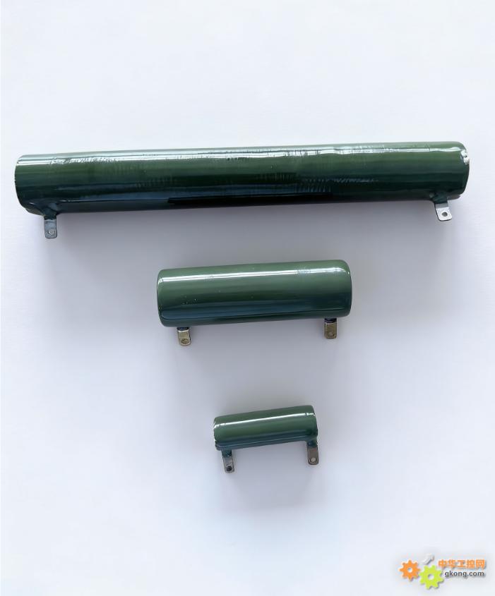

ÐÍ ºÅ£º RXG20
¡ö²úÆ·½éÉÜ
RXG20±»ÓÔÏßÈÆµç×èÆ÷ÊǸ߹¦ÂÊ¡¢±»ÓÔ²¨ÎÆÏßÈÆµç×èÆ÷£¬Ö÷´òÄ͸ßΡ¢Ä͸ßѹ¡¢¿¹Âö³å¡¢Èý·À¡¢É¢ÈȺã¬ÊÇ±äÆµÆ÷ÖÆ¶¯¡¢µçԴй·Å¡¢¹¤Òµ¸ºÔصÄÖ÷Á÷´ó¹¦Âʵç×è¡£
¶î¶¨¹¦ÂÊ·¶Î§£º8W~500W
¹¤×÷µçѹ·¶Î§£º<1.5kV
¶î¶¨×èÖµ·¶Î§£º0.1Ω~90KΩ
ÄÍѹ£º3500V
¾«¶È£º1%
IPµÈ¼¶£ºIP00
Õñ¶¯£º0.5g
ÎÂÆ¯·¶Î§£º≤400ppm/¡æ
¹¤×÷ζȷ¶Î§£º-55¡æ¡«+375¡æ
¡ö²úÆ·ÌØµã
1.¹¦Âʸ²¸Ç¹ã£º8W–3kW£¨Ö÷Á÷ 50W–2.5kW£©¡£
2.³¬Ä͸ßΣº¹¤×÷ÎÂ¶È **-55¡æ~+375¡æ**£¬´É¹ÜÄÍ 1400¡æ¡£
3.Ä͸ßѹ£ºµç¼«ÓëÖ§¼Ü¼äAC 3.5kV/1min¡£
4.¿¹Âö³åÇ¿£º¶Ìʱ¹ýÔØ10 ±¶ / 6s¡£
5.Èý·ÀÐÔÄÜ£º·À³±¡¢·À³¾¡¢·ÀÎÛ£¬Êʺ϶ñÁÓ»·¾³¡£
6.É¢ÈÈÓÅÒ죺²¨ÎÆÈÆÖÆ + ±»ÓÔ£¬ÈÈ×èµÍ¡¢ÎÂÉý≤430¡æ¡£
7.¿ÉÑ¡£º¿Éµ÷ÐÍ£¨RXG20-T£©¡¢ÎÞ¸ÐÐÍ£¨NRXG20£©
¡öÓ¦ÓÃÁìÓò
±äƵÆ÷ / ËÅ·þÖÆ¶¯µç×è¡¢Ô¤³äµçµç×裨0.75–100kW£©¡£
µçԴй·Å¡¢½µÑ¹¡¢ÏÞÁ÷¡¢Æô¶¯µç×è¡£
µç»úÆô¶¯¡¢µçÌÝ¡¢Ðгµ¡¢´¬²°¡¢»ú³µ¡¢¹¤Òµ×Ô¶¯»¯¡£
¸ºÔزâÊÔ¡¢ÀÏ»¯Ì¨¡¢Ä£Ä⸺ºÉ¡¢º¸»ú¡¢UPS¡¢¹â·ü / ³äµç×®¡£
