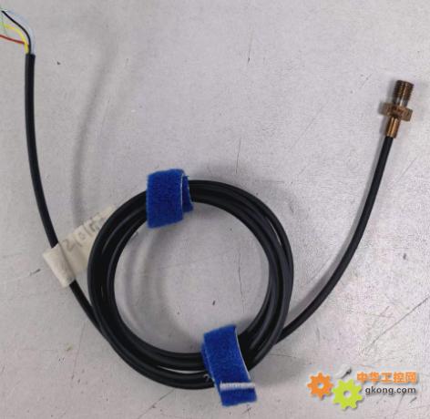

²úÆ·Ãû³Æ£º ¿ÉÌæ»»¿âÀïÌØµÄ΢ÐͶ¯Ñ¹´«¸ÐÆ÷
ÐÍ ºÅ£º HC504A
΢ÐÍѹÁ¦´«¸ÐÆ÷(¾øÑ¹¡¢±íѹ)£º×¨Îª¿ÕÆø¶¯Á¦Ñ§Ñо¿ÊÔÑéÖУ¬ÒªÇó°²×°³ß´çС¡¢²»ÈŶ¯Á÷³¡¡¢¶¯Ì¬ÏìÓ¦ÓÅÁ¼µÄ¶¯Ì¬Ñ¹Á¦·Ö²¼²âÁ¿¶øÉè¼Æ£¬¹ã·ºÓ¦ÓÃÓÚ·¢¶¯»ú½øÆøµÀѹÁ¦»û±ä¡¢´­ÕñµÈ¿ÕÆø¶¯Á¦Ñ§ÐÔÄܲⶨ¡£
Ò»¡¢¶¨Òå
¶¯Ì¬Ñ¹Á¦´«¸ÐÆ÷רÃŲâÁ¿¿ìËٱ仯 / ˲̬ѹÁ¦£¨³å»÷¡¢Âö¶¯¡¢±¬Õ¨¡¢¸ßƵÕñ¶¯£©£¬ºËÐÄÊǸßÏìÓ¦¡¢¿íƵ´ø¡¢Î¢Ãë¼¶·´Ó¦£»Ó뾲̬´«¸ÐÆ÷£¨²âÎÈ̬ / Âý±äѹÁ¦£©±¾ÖÊÇø±ð¡£
¶þ¡¢ºËÐÄÌØµã
ƵÏì¿í£ºµäÐÍ 10 Hz¡«500 kHz+£¬²¶×½¸ßƵѹÁ¦²¨¶¯¡£
ÏìÓ¦¿ì£ºÎ¢Ãë¼¶ÉÏÉýʱ¼ä£¬ÎÞÃ÷ÏÔÖͺó¡£
µÍÏàλÑÓ³Ù£ºÖÜÆÚÐźű£Õæ¶È¸ß¡£
¸ß¹ÌÓÐÆµÂÊ£ºÔ¶¸ßÓÚ±»²âÐźţ¬±ÜÃâ¹²ÕñÊ§Õæ¡£
ÎÞ¾²Ì¬Æ¯ÒÆ£¨Ñ¹µçʽ£©£ºÖ»ÏìÓ¦±ä»¯£¬²»²âºã¶¨Ñ¹Á¦¡£
Ö÷Á÷ÀàÐÍÓëÔ­Àí
1£©Ñ¹µçʽ£¨³£Óã©
Ô­Àí£ºÊ¯Ó¢ / PZT ÌÕ´ÉÊÜѹÁ¦²úÉúµçºÉ£¬µçºÉÓëѹÁ¦³ÉÕý±È¡£
ÌØµã£ºÆµÏì×î¿í¡¢ÏìÓ¦¿ì¡¢²»Ä;²Ì¬¡¢ÐèµçºÉ·Å´óÆ÷¡£
µäÐÍ£ºICP/IEPE ÐÍ£¨ÄÚÖõç·£¬ºãÁ÷¹©µç£©¡£
2£©Ñ¹×èʽ£¨MEMS£©
Ô­Àí£º¹èĤƬÊÜѹ±äÐΣ¬µç×è±ä»¯£¬ÇÅ·Êä³öµçѹ¡£
ÌØµã£º¿É²â¾²Ì¬ + ¶¯Ì¬¡¢ÖÐ¸ßÆµ£¨0¡«10 kHz£©¡¢Ð¡ÐÍ»¯¡¢µÍ³É±¾¡£
3£©µçÈÝʽ
Ô­Àí£ºÑ¹Á¦¸Ä±ä¼«°å¼ä¾à£¬µçÈݱ仯£¬×ªµçѹÐźš£
ÌØµã£º¸ß¾«¶È¡¢µÍÆ¯ÒÆ¡¢ÆµÏìÖеȣ¨0¡«100 kHz£©
