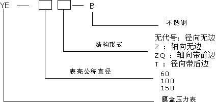

²»Ðâ¸ÖĤºÐѹÁ¦±íYE-60-B/100-B/150-BϵÁÐ
²»Ðâ¸ÖĤºÐѹÁ¦±í¿É²âÁ¿ÓÐÒ»¶¨¸¯Ê´ÐÔµÄÆøÌå»òÒºÌåµÄ΢СѹÁ¦¡£ÒDZíµÄÍâ¿Ç¼°µ¼Ñ¹ÏµÍ³²ÉÓÃ1Cr18Ni9²»Ðâ¸Ö²ÄÁÏ¡£
ÐͺÅÃüÃû£º
¼¼Êõ²ÎÊý£º

×¢£ºÖáÏò¿É°´ÒªÇó´ø·½ÐÎǰ±ß¡£
ʹÓù¤×÷ζȣº-40¡æ¡«70¡æ
ÒDZíÖ´Ðбê×¼£ºQ/320211 DGH02-2003
