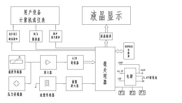

  Á÷Á¿¼ÆÓÉÒÔÏÂÆß¸ö»ù±¾²¿¼þ×é³É£¨Í¼1£©£º
1.ÐýÎз¢ÉúÌå
    ÓÃÂÁºÏ½ðÖÆ³É£¬¾ßÓÐÒ»¶¨½Ç¶ÈµÄÂÝÐýҶƬ£¬Ëü¹Ì¶¨ÔÚ¿ÇÌåÊÕËõ¶Îǰ²¿£¬Ç¿ÆÈÁ÷Ìå²úÉúÇ¿ÁÒµÄäöÎÐÁ÷¡£
¢² ¿ÇÌå
     ±¾Éí´øÓз¨À¼£¬²¢ÓÐÒ»¶¨ÐÎ×´µÄÁ÷ÌåͨµÀ£¬¸ù¾Ý²»Í¬µÄ¹¤×÷ѹÁ¦£¬¿ÇÌå²ÄÁϿɲÉÓÃÖýÂÁºÏ½ð»ò²»Ðâ¸Ö¡£          (ͼ1)
¢³ ÖÇÄÜÁ÷Á¿¼Æ»ýËãÒÇ£¨Ô­Àí¼ûͼ3£©
     ÓÉζȡ¢Ñ¹Á¦¼ì²âÄ£ÄâͨµÀ¡¢Á÷Á¿¼ì²âÊý×ÖͨµÀÒÔ¼°Î¢´¦Àíµ¥Ôª¡¢Òº¾§Çý¶¯µç·ºÍÆäËü¸¨Öúµç·×é³É£¬²¢ÅäÓÐÍâÊäÐźŽӿڡ£
4. ζȴ«¸ÐÆ÷
    ÒÔPt100²¬µç×èΪζÈÃô¸ÐÔª¼þ£¬ÔÚÒ»¶¨Î¶ȷ¶Î§ÄÚ£¬Æäµç×èÖµÓëζȳɶÔÓ¦¹ØÏµ¡£
5. ѹÁ¦´«¸ÐÆ÷
     ÒÔѹ×èʽÀ©É¢¹èÇÅ·ΪÃô¸ÐÔª¼þ£¬ÆäÇű۵ç×èÔÚÍâ½çѹÁ¦×÷ÓÃÏ»ᷢÉúÔ¤ÆÚ±ä»¯£¬Òò´ËÔÚÒ»¶¨¼¤ÀøµçÁ÷×÷ÓÃÏ£¬ÆäÁ½¸öÊä³ö¶ËµÄµçλ²îÓëÍâ½çѹÁ¦³ÉÕý±È¡£
6. ѹµç¾§Ìå´«¸ÐÆ÷
    °²×°ÔÚ¿¿½ü¿ÇÌåÀ©ÕÅ¶ÎµÄºí²¿£¬¿É¼ì²â³öäöÎнø¶¯µÄƵÂÊÐźš£
¢· ÏûÐýÆ÷
     ¹Ì¶¨ÔÚ¿ÇÌå³ö¿Ú¶Î£¬Æä×÷ÓÃÊÇÏû³ýÐýÎÐÁ÷£¬ÒÔ¼õС¶ÔÏÂÓÎÒDZíÐÔÄܵÄÓ°Ïì¡£
2.2 ¹¤×÷Ô­Àí
    Á÷Á¿´«¸ÐÆ÷¿ÇÌåÆÊÃæµÄÐÍÏßÀàËÆÎÄÇðÀû¹ÜµÄÐÍÏߣ¬Á½Í·´óÖмäС£¬Èë¿Ú²àµÄÊÕËõ¶ÎÄÚÓÐÒ»×éÇ¿ÖÆ²úÉúÐýÎеĵ¼Á÷ҶƬ£¬³ö¿Ú²àÓÐÒ»¸öÏû³ýÐýÎÐÁ÷µÄÕûÁ÷Õ¤£¬Ê¹Á÷Ìå»Ö ¸´ÖáÏòÁ÷¶¯¡£µ±Á÷ÌåÁ÷ÈëÁ÷Á¿Á÷Á¿´«¸ÐÆ÷ʱ£¬Èë¿Ú´¦µÄµ¼Á÷ҶƬÆÈʹÖáÏòÁ÷¶¯µÄÁ÷ÌåÐýת£¬²¢ÔÚÊÕËõ¶ÎÄÚÓÉÓÚÁ÷ÌåµÄ¼ÓËÙÁ÷¶¯Ê¹ÐýתÁ÷µÄÖÐÐIJúÉúÐýÎÐÁ÷¡£Õâʱ£¬Ëæ ׏ܽØÃæµÄËõС£¬ÐýÎÐÁ÷¼¯ÖÐÔÚÖÐÐÄÖáÉÏ£¬µ±ÐýÎÐÁ÷Ìå½øÈëÀ©É¢¶Îʱ£¬ÓÉÓÚÁ÷ËÙ¼õÂý£¬ÐýתÁ÷ÌåÊܵ½»ØÁ÷µÄ×÷Ó㬿ªÊ¼×÷¶þ´ÎÐýת£¬ÐýÎÐÁ÷³öÏÖתÕ۵㣨ÔÚÕâÒ»µãÉÏ Á÷ÌåµÄÖáÏòËÙ¶È·ÖÁ¿ÎªÁ㣩£¬ÐγÉÐýÎнø¶¯ÏÖÏ󣬹ʳÆÐý½øÐýÎС£¼ì²âÔª¼þ²âµÃ¸Ã½ø¶¯ÆµÂÊÐźźó£¬Óɶþ´ÎÒDZíÏÔʾ³öÁ÷Á¿×ÜÁ¿¡¢Î¶ȡ¢Ñ¹Á¦µÈ¡£
2.3 Á÷Á¿»ýËãÒǹ¤×÷Ô­Àí
