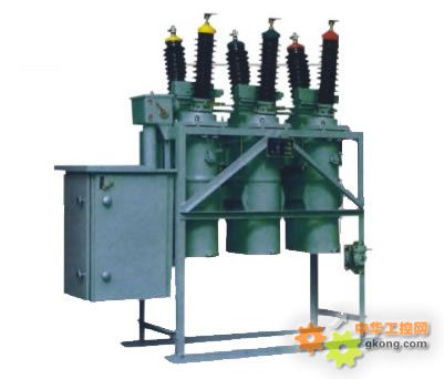

DW13-35/1250-20-25-31.5-40.5Ð͸ßѹ¶àÓͶÏ·Æ÷ÌõÀý·ûºÏ¹ú¼Ò±ê×¼,ÓÃÓÚ35KVµçÁ¦ÏµÍ³µÄ±£»¤.¿ØÖƺÍϵͳ¼äÁªËø.¶Ï·Æ÷ÓÖ·ÖΪ²»´ø²¢Áªµç×è¼°´ø²¢Áªµç×èÁ½ÖÖ,
Á½Õß¾ßÓÐÏàͬµÄ¼¼Êõ²ÎÊýºÍ»ù±¾¼¼ÄÜ,´ø²¢Áªµç×è¶Ï·Æ÷»¹¾ßÓпɿ¿µÄÇкϿÕÔØ³¤ÏßÐÔÄÜ,Óû§±ØÐëÇкϿÕÔØ³¤Ïߵij¡ºÏ,¶Ï·Æ÷¿ÉÓÃÓÚ½ÏÖØµÄÎÛ»àµØÇøºÍ¸ßÔ­µØÇø.
Ö÷Òª¼¼Êõ²ÎÊý
Ïî Ä¿µ¥ λ¼¼ÊõÊý¾Ý±¸ ×¢
DW13-35ÐÍDW132-35 IÐÍ
¶î¶¨µçѹKV35£¨36£©35£¨36£©
×î¸ß¹¤×÷µçѹÖ÷KV40.5(36)40.5(36)
¶î¶¨ÆµÂÊHz5050
¶î¶¨µçÁ÷A12501600
¶î¶¨¶Ì·¿ª¶ÏµçÁ÷KA2031.5
¶î¶¨Ê§²½¿ª¶ÏµçÁ÷KA58
¶î¶¨¶Ì·¹ØºÏµçÁ÷(·åÖµ)KA5080
¶¯Îȶ¨µçÁ÷(·åÖµ)KA5080
¶¯Îȶ¨µçÁ÷KA2031.5
¶î¶¨ÈÈÎȶ¨Ê±¼äS44
³öÏ߶˶Ì·ʱµÄ¶î¶¨Ë²Ì¬»Ö¸´µçѹ(·åÖµ,ÂúÈÝÁ¿¿ª¶Ïʱ)KV69.469.4
¶î¶¨À×µç³å»÷ÄÍÊܵçѹ(·åÖµ)KV185185
¶î¶¨¶Ìʱ(1min)¹¤ÆµÄÍÊܵçѹKV80958095
ºÏբʱ¼äS¡Ü0.35¡Ü0.35
·Öբʱ¼äS¡Ü0.07¡Ü0.07
È«¿ª¶Ïʱ¼äS0.10.1×¢ 3
"ºÏ·Ö"²Ù×÷ʱµÄ½ðÊô¶Ì½Óʱ¼äS0.10.1
¶î¶¨²Ù×÷˳Ðò·Ö0.5S-ºÏ·Ö-180S-ºÏ·Ö
ÊÊÓú£°Î¸ß¶ÈÓÃ×÷±£»¤.¿ØÖÆm40004000
ÓÃ×÷ÁªÂçm30003000
Çпճ¤Ïß·³¤¶ÈKm5050
´ÉÌ×ÅÀµç¾àÀëcm105105
¶Ï·Æ÷ÖØÁ¿(´ø»ú¹¹.ÎÞÓÍ)kg13501930
