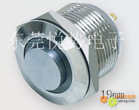

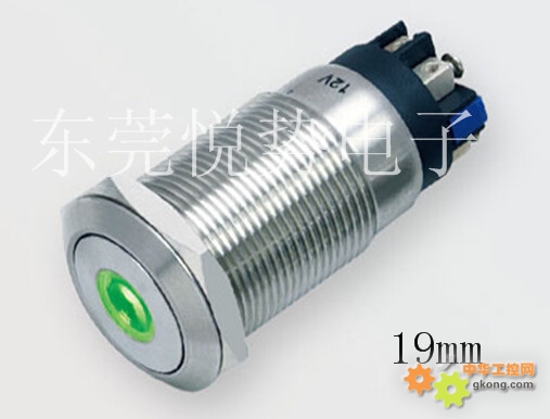

5A/250VAC×Ô¸´Ê½/×ÔËøÊ½-½ðÊô´øµÆ·ÀË®°´Å¥¿ª¹Ø
°²×°¿×³ß´ç£ºMounting hole size£ºΦ19mm
¿ª¹Ø¶î¶¨Öµ£ºSwitch rating :5A/250VAC
¿ª¹Ø×éºÏ£ºSwitch combination :1NO1NC/2NO2NC
²Ù×÷ÀàÐÍ£ºOperation types:×Ô¸´Ê½Reesetable/×ÔËøÊ½Self-locking
Í·²¿ÐÎ×´£ºHead shape:ƽÐÎfiat/¸ßƽÐÎHigh flush
´øµÆ·½Ê½£ºLamp type£º»·ÐδøµÆRing llluminated/µ¥µã´øµÆDot llluminated/×Ö·û´øµÆCharacter llluminated
Íâ¿Ç²ÄÁÏ£º»ÆÍ­¶ÆÄø/²»Ðâ¸Ö
Enclosure material:Nickel piated brass/Stainless stell
·À»¤µÈ¼¶ Degree of protection:IP67,IK10
PYCA12mm²úÆ·ÖÐÎĹæ¸ñ
β²¿ÅäÖ㺽ÓÏ߲寬Connection terminal£¨2.8*0.5£©
¿ª¹Ø¹æ¸ñ£º5A/250VAC
½Ó´¥µç×裺≤50mΩ
¾øÔµµç×裺≥ 1000mΩ
¾øÔµÇ¿¶È£º2000VAC
»µ¾³Î¶ȣº-20¡æ—+55¡æ
»úеÊÙÃü:50Íò´ÎÒÔÉÏ500000 cycles
µçÆøÊÙÃü£º5Íò´ÎÒÔÉÏ50000 cycles
Ãæ°åºñ¶È£º1—10mm
ÂÝĸŤ¾Ø£º5-14Nm
²Ù×÷ѹÁ¦£ºÔ¼3-5N About3-5N
²Ù×÷Ðг̣ºÔ¼2.5mm About2.5mm
·À»¤µÈ¼¶£ºIP67£¬IK10
²ÄÁÏ
´¥µã£ºÒøºÏ½ðSilver alloy
°´¼ü£º»ÆÍ­¶ÆÄø/²»Ðâ¸ÖNickel piated brass/stainless stell
Íâ¿Ç£º»ÆÍ­¶ÆÄø/²»Ðâ¸ÖNickel piated brass/stainless stell
»ù×ù£ºPA66
µÆÖé²ÎÊý
µÆÖéÀàÐÍ£º»·ÐδøµÆRing llluminated£¨LED)/µ¥µã´øµÆDot llluminated/×Ö·û´øµÆCharacter llluminated
¶î¶¨µçѹ£º6V/12V/24V/110V/22OV
µÆÖéÑÕÉ«£ººìÉ« ³ÈÉ« »ÆÉ« ÂÌÉ«À¶É« °×É«
µÆÖéÊÙÃü£º40000Сʱhour
