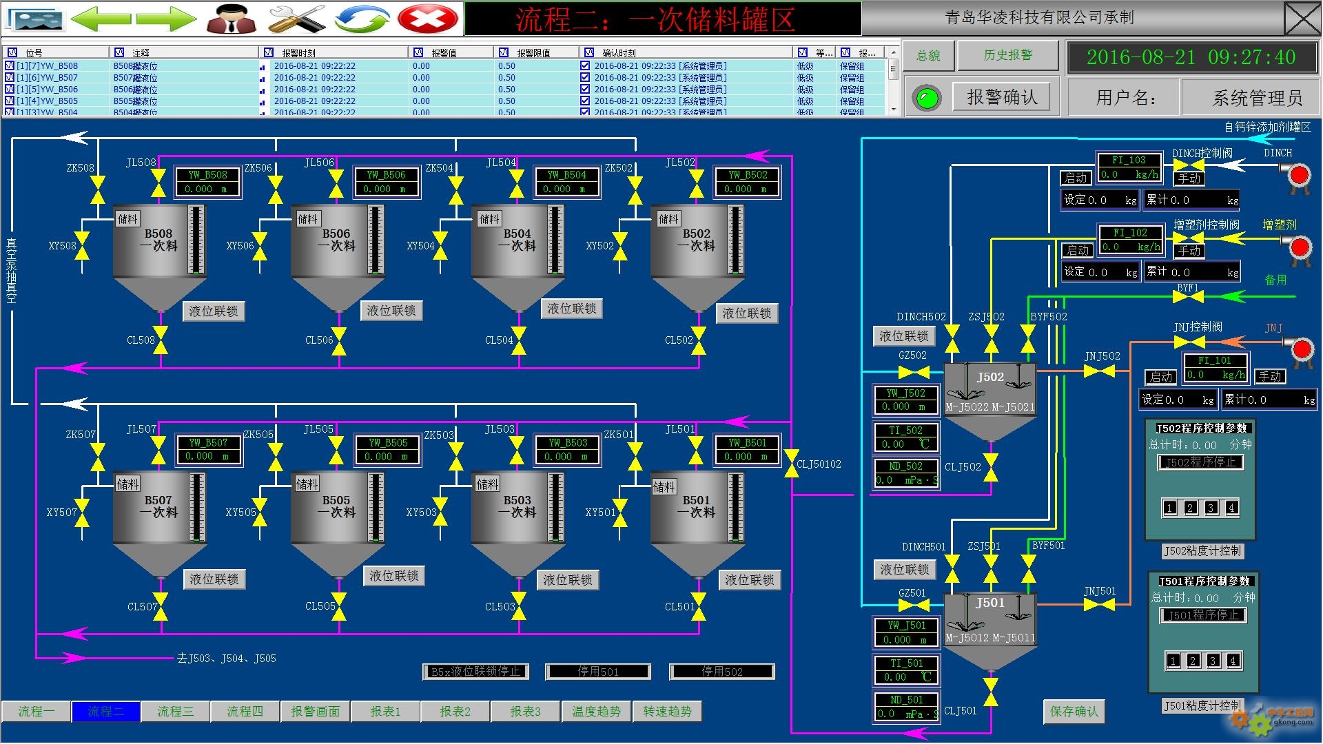

Ôö¼ÓÆÆ´ü»ú²¢ÓýÊÁýÊäËÍ
¢ÅÆÆ´ü»úÔ­Àí£º¼Ðס´ü×ÓËĽǣ¬´ÓÏ·½ÆÆ´ü²¢½øÐж¶¶¯ÂäÁÏ£¬¼õÉÙÓàÁϲд档
¢ÆÆÆ´üÍê³Éºó£¬·ÛÁÏÓɽÊÁýÊäËÍ´ø½øÈë½Á°è¹Þ¡£
2
¢Û
ÆÆ´üǰ¼ÓÊäËͲ¢¼ì²â
¢ÅÆÆ´ü»úǰÓÐÊäËÍ´øÁ¬½Ó£¬²¢ÔÚÊäËÍ´øÉ϶ԴüÁϽøÐмì²â¡¢×Ô¶¯¼Ç¼Ͷ·ÛÁ¿£¨µ¥Î»KG£©;
3
¢Ü
ÔÚCa¡¢Ð¿Ô­ÁϹÞÉÏÔö¼Ó³ÆÖØ´«¸ÐÆ÷
¢ÅÔÚÔ­ÁϹÞÉÏÔö¼Ó³ÆÖØ´«¸ÐÆ÷£¬ÐźÅͨ¹ý±äËÍÏÔʾµ¥Î»ÎªKG£»
¢ÆÈ˹¤ÊäÈë¼ÓÁÏÁ¿£¬´«¸ÐÆ÷¾«È·¿ØÖÆ£¬´ïµ½¼ÓÁÏÁ¿ºó×Ô¶¯¿ØÖÆ·§ÃŹرգ¬´ïµ½¾«È·¼ÓÁÏ¡£
4
¢Ý
Ò»´Î½Á°è¡¢´¢ÁÏ×Ô¶¯¿ØÖÆ
¢ÅÒ»´Î½Á°è£ºÔ­²ÄÁϼÓÁÏÍê³ÉºóÒ»´Î½Á°è×Ô¶¯¿ªÆô£»
¢ÆÒ»´Î´¢ÁÏ£ºÒ»´Î´¢¹Þ¾ùÔö¼ÓҺλ´«¸ÐÆ÷£¬¼ì²âÊÇ·ñ¿Õ¹Þ£¬²¢¶ÔÓ¦¶ÀÁ¢±àºÅ£¬Ò»´Î½Á°èÍê³ÉºóÓÉÈ˹¤Ñ¡Ôñ´¢ÁϹޣ¬°´Ï“´¢Áϰ´Å¥”×Ô¶¯¿ªÆôÕæ¿Õ±Ã¼°Ïà¹Ø´¢ÁϽøÁÏ·§ÃÅ£¬ÊµÏÖ×Ô¶¯´¢ÁÏ¡£

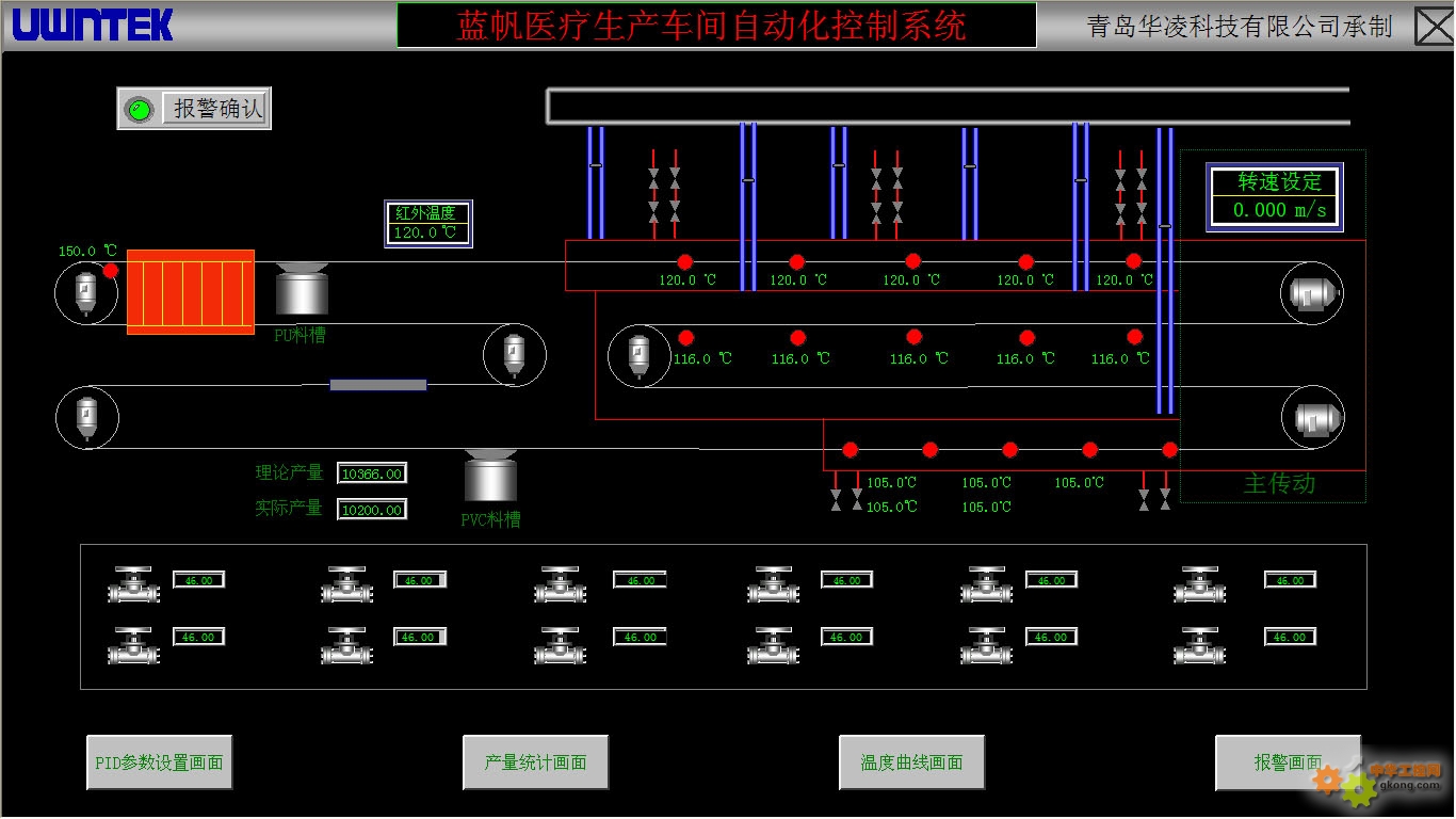

3. ϵͳÈíÓ²¼þ¹¦ÄÜÉè¼Æ
Èí¼þÉè¼Æ·½Ãæ²Ù×÷Ô±¡¢¹¤³Ìʦ¡¢¹ÜÀíÈËÔ±µÄ²»Í¬¼¶±ð½øÐÐ×¢²á£¬ÊµÏÖÓû§¿ØÖÆÈ¨ÏÞ¹ÜÀí¹¦ÄÜ£»¸ù¾Ý²É¼¯µ½¹¤ÒÕ²ÎÊý½øÐÐÊý¾Ý´¦Àí¡¢´æ´¢¡¢¼Ç¼¡¢´òÓ¡µÈ£»
¹¤ÒÕÁ÷³Ì»­ÃæÏÔʾ¡¢É豸״̬ÃèÊö¼°¹ý³Ì²ÎÊýµÄ¶¯Ì¬ÏÔʾ¹¦ÄÜ£¬Ã¿Ì¨·§ÃŵĿª¹Ø×´Ì¬ÏÔʾ£¬ÒºÎ»ºÍѹÁ¦ÏÔʾÒÔ¼°ÆäËü¹¤ÒÕ²ÎÊýµÄÖ±¹Û¶¯Ì¬ÏÔʾ£»
¹¤ÒÕ²ÎÊýÉ趨Óëµ÷Õû¼°»ØÂ·¿ØÖƲÎÊýÔÚÏßÕû¶¨¹¦ÄÜ£»
¹¤ÒÕ²ÎÊýÇ÷ÊÆÇúÏß(ʵʱÇ÷ÊÆ¼°ÀúÊ·Ç÷ÊÆ)ÏÔʾÓë´òÓ¡¹¦ÄÜ£»
±¨¾¯»­ÃæÏÔʾ£»´òÓ¡±¨¾¯¡¢±¨¸æ¡¢Ê¼þ£»ÊµÊ±±¨¾¯/ʼþÐÅÏ¢´òÓ¡¹¦ÄÜ£»
ʼþ¼Ç¼(²Ù×÷Ô±²Ù×÷¼Ç¼£¬¹¤ÒÕ²ÎÊý»òÉ豸״̬Óë¿ØÖÆ·½Ê½¸Ä±ä£¬±¨¾¯²úÉú¡¢È·ÈϵÈ) ¹¦ÄÜ£»
¾ßÓжàÖÖ±¨¾¯¼à²âÈ磺Һλ¸ß/µÍÏÞ¡¢Î¶ȸß/µÍÏ޵ȱ¨¾¯£»
¾ßÓÐÅäÖòÎÊýÐÞ¸Ä×Ô¶¯¼Ç¼ºÍ¸÷À౨¾¯µÄ×Ô¶¯¼Ç¼¹¦ÄÜ£¬Ìá¸ßÁËϵͳµÄ¿É×·ËÝÐÔ£¬ÔöÇ¿ÁËϵͳµÄ·À·¶ÄÜÁ¦£»
¼à¿ØÏµÍ³Ó²¼þ¹ÊÕÏÕï¶ÏÓë״̬¼àÊÓ¹¦ÄÜ£»
ÀúÊ·Êý¾Ý²É¼¯Óë×Ô¶¯¹éµµ´æ´¢¹¦ÄÜ£»¾ßÓжàÖÖÀà±ðµÄÊý¾Ý²éѯ¹¦ÄÜ£¬¿É°´Ö¸¶¨µÄʱ¼ä¶Îͳ¼Æ£¬ËùÓÐÊý¾Ý¿É±£´æÒ»ÄêÒÔÉÏ£»
À¶·«Ò½ÁÆËܽºÊÖÌ×ÅäÁϳµ¼ä×Ô¶¯»¯¿ØÖƸÄÔì²ÉÓÃÕã´óDCSϵͳÍê³É¡£²ÉÓÃÓ²¼þÈßÓàÉè¼Æ£¬¿ØÖÆÄ£¼þË«ÖØÈßÓ࣬µçÔ´Ä£¼þË«±¸ÓÃÈßÓ࣬´ó´óÌá¸ßÁËϵͳ¿É¿¿ÐÔ¡£¸ù¾ÝÉÏÊöÎÊÌâ½áºÏ¼È¶¨·½°¸£¬ÓÐÕë¶ÔÐԵıàÖÆÏàÓ¦µÄ¿ØÖÆËã·¨²»½öÍê³ÉÁËÕ³¶ÈµÄ×Ô¶¯¿ØÖÆ£¬¸üÊÇʵÏÖÁËÕû¸ö³µ¼äµÄÍêÈ«×Ô¶¯»¯Éú²ú¡£
