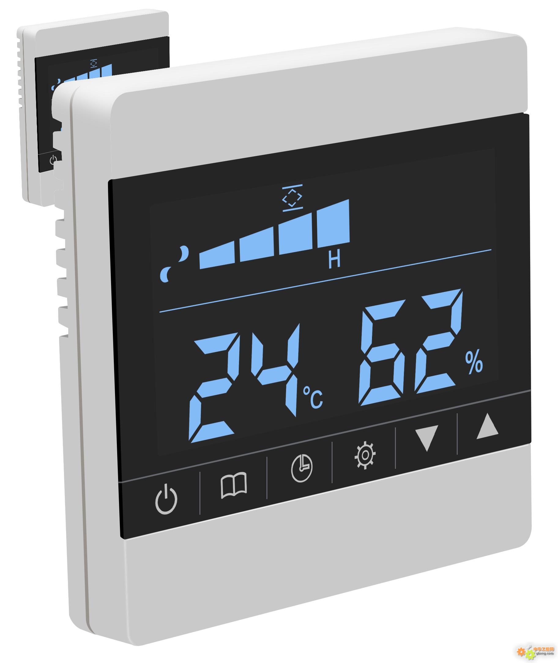

KF-900Cзçϵͳ¿ØÖÆÆ÷˵Ã÷Êé
Ò»¡¢¸ÅÊö
Òº¾§ÊýÏÔÐÂ·ç¿ØÖÆÆ÷£¬²ÉÓÃоƬʽÎÂʪ¶È´«¸ÐÆ÷£¬¿Éʵʱ¼à²âÊÒÄÚζȡ¢Êª¶È£¬²ÉÓô¥Ãþ°´¼ü¼¼Êõ£¬²Ù×÷·½±ãÁé»î£¬¿ØÖÆÆ÷Êä³öÐźÅÖ±½Ó¿ØÖÆÐ·ç»úµÄÆô¶¯¼°×ªËÙ¡£
¶þ¡¢°´¼ü¹¦ÄÜ˵Ã÷
1¡¢¶¨Ê±²ÎÊýÉ趨
2¡¢Çл»ÅÔͨ·§×´Ì¬
3¡¢ÏÔʾÂËÍø¹¤×÷ʱ¼ä
4¡¢ÉèÖÃÂËÍø¹¤×÷ʱ¼ä
5¡¢²ÎÊýÉϵ÷¼ü
6¡¢²ÎÊýϵ÷¼ü
Èý¡¢Ïêϸ˵Ã÷
1¡¢¿ª¹Ø»ú£º¶Ì°´¿ªÆô»ò¹Ø±Õ¿ØÖÆÆ÷¡£¿ØÖÆÆ÷¹Ø±ÕʱÆÁÄ»ÏÔʾOFF£¬Êä³ö¹Ø±Õ¡£
2¡¢·çËÙµ÷Õû£ºÍ¨¹ý¶Ì°´¿Éµ÷Õû·ç»úÍ£Ö¹¡¢µÍËÙ¡¢ÖÐËÙ»ò¸ßËÙ״̬¡£
3¡¢ÅÔͨ·§£º¶Ì°´¿ªÆô»ò¹Ø±ÕÅÔͨ·§¡£
4¡¢ÂËÍø¹¤×÷ʱ¼äÉèÖ㺳¤°´¼ü2Ãë½øÈëÂËÍø¹¤×÷ʱ¼äÉèÖã¬Ô­ÏÈÏÔʾζȺÍʪ¶ÈλÖý«ÏÔʾÂËÍøÉèÖÃʱ¼ä²¢ÉÁ˸£¬Í¨¹ýÐÞ¸ÄÊýÖµ£¬ÉèÖ÷¶Î§0-9900Сʱ¡£
5¡¢³¬¹ý30ÃëÎÞ°´¼ü²Ù×÷£¬¿ØÖÆÆ÷ÏÔʾ×Ô¶¯¹Ø±Õ¡£
ËÄ¡¢¼¼Êõ²ÎÊý
*ÍâÐγߴç:86×86×40mm
*ζÈÏÔʾ·¶Î§£º0¡æ——50¡æ
*°²×°¿×¾à£º60mm
*¹¤×÷ζÈ:-10¡æ --- +50¡æ
*½ÓÏß¶Ë×Ó£º2.5 mm2
*¹¤×÷ʪ¶È:5£¥RH——90£¥RH(·Ç½á¶)
*¶î¶¨µçѹ:AC220V 50Hz
*´æ´¢Î¶È:-10¡æ --- +60¡æ
*´ý»ú¹¦ºÄ:≤2.0W
*´æ´¢Êª¶È:≤60£¥RH
*¿ØÖƹ¦ÂÊ:≤200W
*Êä³ö½Ó¿Ú£º½»Á÷/Ö±Á÷·ç»ú
