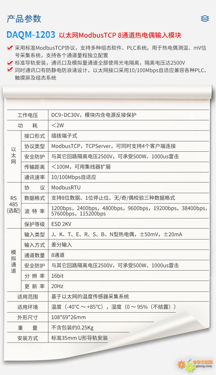

ÐÍ ºÅ£º DAQM-1203

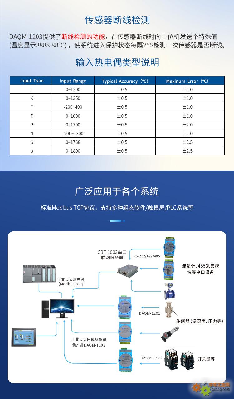

DAQM-1203 ²ÉÓñê×¼ ModbusTCP ЭÒ飬֧³Ö¶àÖÖ×é̬Èí¼þ¡¢PLC ϵͳ¡£ÓÃÓÚÈȵçż²âΡ¢mV
ÐźŲɼ¯ÏµÍ³£¬Ö§³Ö¸÷¸öͨµÀÁ¿³Ì¶ÀÁ¢ÅäÖá£Ö§³Ö DC9-30V ¿í¹¤×÷µçѹ£¬±ê×¼µ¼¹ì°²×°£¬Í¨Ñ¶¿Ú
¼°Ä£ÄâÁ¿Í¨µÀÈ«²¿Ê¹Óùâµç¸ôÀ룬¸ôÀëµçѹ´ï 2500V£¬Í¬Ê±Í¨Ñ¶¿ÚÓзÀ¾²µç·ÀÀËÓ¿Éè¼Æ£¬ÒÔÌ«Íø
½Ó¿Ú²ÉÓà 10/100Mbps ×ÔÊÊÓ¦¼æÈݸ÷ÖÖ PLC¡¢´¥ÃþÆÁ¼°×é̬ϵͳ
