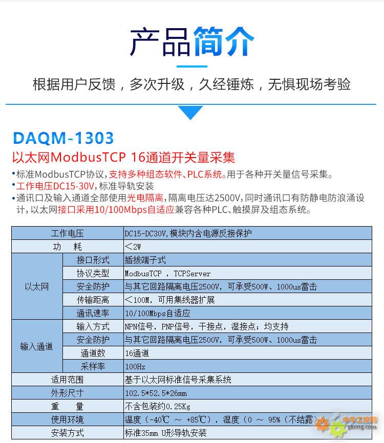

¡ú ÒÔÌ«ÍøModbusTCP16ͨµÀÊý×ÖÁ¿ÊäÈëÄ£¿éDAQM-1303
²úÆ·Ãû³Æ£º
ÐÍ ºÅ£º
DAQM-1303
0.00
DAQM-1303 ²ÉÓñê×¼ ModbusTCP ÐÒ飬֧³Ö¶àÖÖ×é̬Èí¼þ¡¢PLC ϵͳ¡£ÓÃÓÚ¸÷ÖÖ¿ª¹ØÁ¿ÐźŲɼ¯¡£²úÆ·¹¤×÷µçѹ DC9V-30V£¬±ê×¼µ¼¹ì°²×°£¬Í¨Ñ¶¿Ú¼°ÊäÈëͨµÀÈ«²¿Ê¹Óùâµç¸ôÀ룬¸ôÀëµçѹ´ï
2500V£¬Í¬Ê±Í¨Ñ¶¿ÚÓзÀ¾²µç·ÀÀËÓ¿Éè¼Æ£¬ÒÔÌ«Íø½Ó¿Ú²ÉÓà 10/100Mbps ×ÔÊÊÓ¦¼æÈݸ÷ÖÖ PLC¡¢´¥
ÃþÆÁ¼°×é̬ϵͳ¡£
¹¤×÷µçѹ DC9V-DC30V,Ä£¿éÄÚº¬µçÔ´·´½Ó±£»¤
¹¦ºÄ
£¼2W
ÒÔÌ«Íø
½Ó¿ÚÐÎʽ ²å°Î¶Ë×Óʽ
ÐÒéÀàÐÍ ModbusTCP £¬TCPServer
°²È«·À»¤ ÓëÆäËü»ØÂ·¸ôÀëµçѹ 2500V£¬¿É³ÐÊÜ 500W¡¢1000us À×»÷
´«Êä¾àÀë £¼100M£¬¿ÉÓý»»»»úÀ©Õ¹
ͨѶËÙÂÊ 10/100Mbps ×ÔÊÊÓ¦
