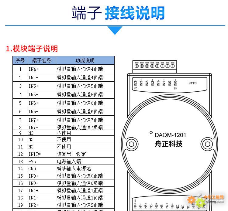

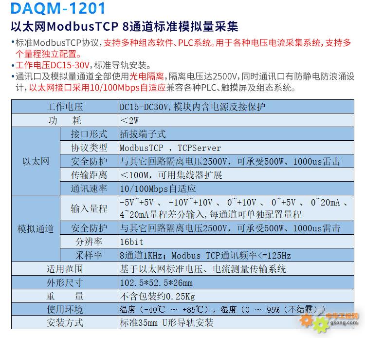

DAQM-1201 ²ÉÓñê×¼ ModbusTCP ЭÒ飬֧³Ö¶àÖÖ×é̬Èí¼þ¡¢PLC ϵͳ¡£ÓÃÓÚ¸÷ÖÖµçѹµçÁ÷²É¼¯ÏµÍ³£¬Ö§³Ö¶à¸öÁ¿³Ì¶ÀÁ¢ÅäÖᣲúÆ·¹¤×÷µçѹ DC9-30V£¬±ê×¼µ¼¹ì°²×°£¬Í¨Ñ¶¿Ú¼°Ä£ÄâÁ¿Í¨µÀÈ«²¿Ê¹Óùâµç¸ôÀ룬¸ôÀëµçѹ´ï 2500V£¬Í¬Ê±Í¨Ñ¶¿ÚÓзÀ¾²µç·ÀÀËÓ¿Éè¼Æ£¬ÒÔÌ«Íø½Ó¿Ú²ÉÓÃ10/100Mbps ×ÔÊÊÓ¦¼æÈݸ÷ÖÖ PLC¡¢´¥ÃþÆÁ¼°×é̬ϵͳ¡£
