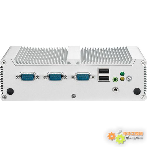

CPU
板载 Intel® Atom™ D425 处理器, 1.8 GHz Intel® ICH8M 芯片组
内存
1 x DDR3 SO-DIMM 插槽, 单通道, 支持可达 2GB DDR3 667/800 SDRAM, 无缓存 non-ECC
I/O 接口-前面板
ATX 电源开/关按钮, HDD access/ power status LEDs 3 x COM ports: COM2: RS232/422/485; COM3& COM4: RS232 2 x USB2.0 pocrt Audio jack (speaker-out, Mic-in) 2 x Antenna holes
I/O 接口-后面板
1 x VGA COM1: 1x RS232 2 x Intel® GbE LAN port 2 x USB2.0 port +12V DC power input 1 x DB15 male digital input & output
数字输入 & 输出
4 x Digital Input (Source type): Input Voltage (Dry Contact): Logic 0: Close to GND; Logic 1: Open Input Voltage: Logic 0: 3V max; Logic 1: +5V ~ +30V 4x Digital Output (Sink type): Output Voltage: 3.6V ~ 5V; Sink current: 200 mA max. per channel
设置
1 x 2.5” HDD driver bay 1 x External CF Socket 1 x SATA DOM
电源要求
板载直流电源设计,支持 +12V DC 电源输入 1 个可选 12V, 60W 电源适配器
规格尺寸
185mm (W) x 131mm (D) x 54mm (H) (7.28” x 5.2” x 2.13”)
构造
无风扇铝制机壳设计
环境温度
操作温度: -5°C ~ 55°C (According to IEC60068-2-1, IEC60068-2-2, IEC60068-2-14) 存储温度: -20°C ~ 80°C 相对湿度: 10% ~ 93% (non-Condensing)
通过认证 CE approval FCC Class A
