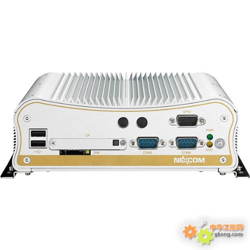

产品名称: NISE 2100A无风扇工业计算机
型  号: NISE 2100A
价  格:
品  牌: 新汉nexcom
主板
NISB 2100A On-board Intel® Atom™ D525 Dual Core processor, 1.8GHz, 1M Cache Intel® ICH8M PCH
内存
1 x DDR3 SO-DIMM 插槽, 支持可达 2 GB DDR3 800 SDRAM 内存模块,无缓存 non-ECC
扩展
1 x PCI expansion 1 x Mini-PCIe socket onboard (Either optional Wi-Fi or Mobile wireless module)
I/O 接口-前面板
ATX Power on/ off switch HDD Access/ Power status LEDs 2 x USB2.0 ports 2 x Serial port (RS232) 1 x external SIM card holder 1 x DB15 GPIO connector 2 x Antenna holes (Either optional Wi-Fi or Mobile wireless module)
I/O 接口-后面板
9 ~ 36V DC 输入, 1 x 3-pin for remote power on/off switch ,1 x DB15 VGA  ,2 x Intel® GbE LAN ,1 x Speaker out ,2 x USB2.0 , 4 x 串口(2x RS232 and 2x RS232/422/485 with auto-flow control, isolation protection on COM1 & COM2)
存储设置
1 x 2.5" SATA HDD drive bay or optional SATA DOM module (Horizontal type) One external CF socket
电源需求
ATX Power mode DC to DC power design on-board, support from 9V ~ 36V DC Optional 19V, 65W power adapter
尺寸规格
195 mm (W) x 200 mm (D) x 90 mm (H) (7.7" x 7.9" x 3.5")
构造
全铝制机壳无风扇设计
环境温度
操作温度: 环境空气流通: -20°C ~ 70°C (工业等级设置)(According to IEC60068-2-1, IEC60068-2-2, IEC60068-2-14) 存储温度: -20°C ~ 80°C 相对湿度: 10% to 93% (Non-condensing)
通过认证 CE approval FCC Class A
关 键 词: 高扩展温度 无风扇工业计算机 D525
