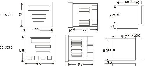

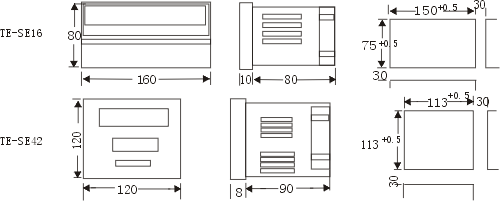

ËÄ¡¢ÍâÐμ°¿ª¿×³ß´ç

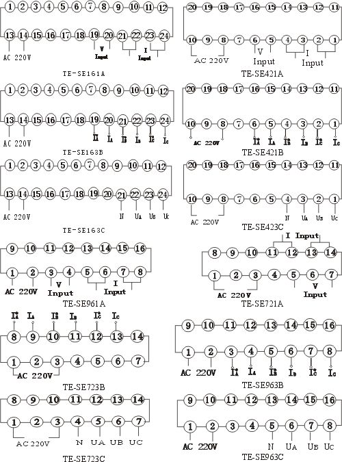

Îå¡¢½ÓÏßͼ
(´Ë½ÓÏßͼ½ö¹©²Î¿¼,¾ßÌå½ÓÏßÒÔÒDZí»ú¿Ç±êǩΪ׼)
