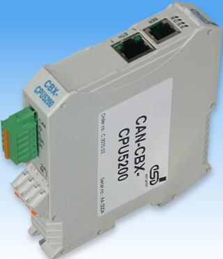

产品名称: CAN-CBX-CPU5200
型  号: CAN-CBX-CPU5200
价  格:

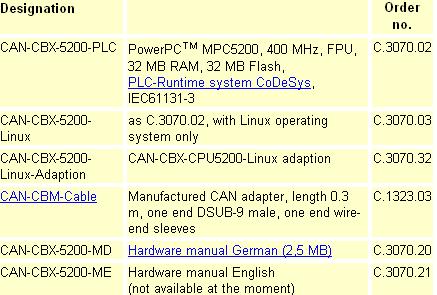

*PowerPCTM MPC5200 with FPU
*10/100BaseT Ethernet (IEEE802.3)
*1x CAN interface, CAN 2.0A/B, 1 Mbit/s, ISO11898, electrical isolation
*1x CAN interface connected to InRailBus, CAN 2.0A/B, 1 Mbit/s, ISO11898
*RS-232 interface at RJ12 connector
*small top hat rail mounting enclosure (EN50022)
*power supply voltage 24 VDC
*option: CoDeSys programming and run-time system according to IEC61131-3
*Linux operating system (option)
