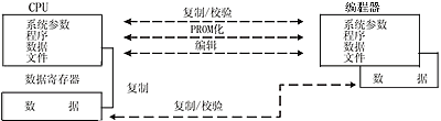

ºÐʽ´æ´¢Æ÷½á¹¹¡¢±ãÓÚ½»»»¡¢Ð¯´ø¡¢±£¹Ü: (Ïê¼ûÏÂͼ)
£¨SU-5ÎÞºÐʽ´æ´¢Æ÷£©
ºÐʽ´æ´¢Æ÷ÀàÐÍ:
CMOS RAMÐÍ: G-03M¡¢G-05M¡¢G-07M
UVPROMÐÍ: G-14M¡¢G-15M
EEPROMÐÍ: G-25M¡¢G-27M
