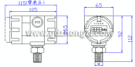

ËÄ¡¢½á¹¹³ß´ç
µç×ÓÍâ¿Ç£ººÏ½ðÂÁ
Ö÷Ìå½á¹¹£º²»Ðâ¸Ö
ÖØÁ¿£ºÔ¼850¿Ë
