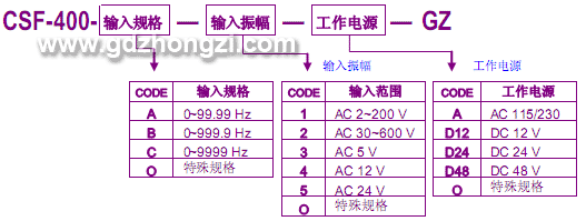

Èý¡¢ÐͺŹæ¸ñÑ¡Ôñ±í

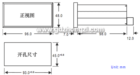

ËÄ¡¢¹æ¸ñ³ß´ç

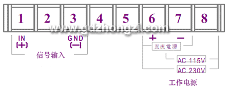

Îå¡¢½ÓÏßͼ
