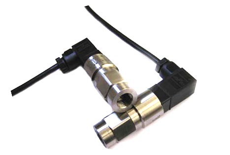

²úÆ·Ãû³Æ£º ¿Õµ÷ѹÁ¦´«¸ÐÆ÷
ÐÍ ºÅ£º MD-A
MD-A ¿Õµ÷ѹÁ¦´«¸ÐÆ÷רҵΪ¿Õµ÷ÒÔ¼°¿Õµ÷ϵͳÉè¼Æ£¬²ÉÓûÆÍ­»ò²»Ðâ¸ÖÍâ¿Ç£¬¾ßÓÐÁ¼ºÃµÄ·À³±ÄÜÁ¦¼°ÓÅÒìµÄ½éÖʼæÈÝÐÔ£¬×¨ÓÃÓÚ¿Õµ÷ѹÁ¦²âÁ¿Óë¿ØÖÆ¡£
      MD-A ¿Õµ÷ѹÁ¦´«¸ÐÆ÷¼¯³ÉÁËÊý×Öµ÷ÀíоƬ£¬¶Ô´«¸ÐÆ÷µÄÆ«ÒÆ¡¢ÁéÃô¶È¡¢ÎÂÆ¯ºÍ·ÇÏßÐÔ½øÐÐÊý×Ö²¹³¥£¬¾ßÓм¯³É¶È¸ß¡¢Ìå»ýС¡¢¾«¶È¸ß¡¢Ò»ÖÂÐԺᢿ¹¸ÉÈÅÄÜÁ¦Ç¿¡¢ÏìÓ¦Ëٶȿ졢¹¦ºÄµÍ¡¢Î¶ȷ¶Î§¿íµÈ×¿Ô½ÌØÐÔ¡£
                       4-20mAµçÁ÷ÐÍ
²úÆ·ÌØµã£º
1¡¢  ¸ßÆ·Öʲ»Ðâ¸ÖѹÁ¦½Ó¿Ú£¬Á¼ºÃµÄ¿¹¸¯Ê´ÐÔÄÜ¡£
2¡¢  ¸Ä½øÓÅ»¯µÄµç·ÒÔ¼°°²×°½á¹¹£¬¾ßÓÐÓÅÐãµÄ¿¹Õð¶¯ÐÔÄܺÍÎȶ¨ÐÔ¡£
3¡¢  ¿ÉÑ¡¸´ºÏѹÁ¦Á¿³Ì£¬Èç-100Kpa¡«3MPa
4¡¢  ¸ü¿íµÄÎÂÇø²âÁ¿£¬¿É´ï-20¡«110¡æ£¬-40¡«150¡æ¡£
¼¼Êõ²ÎÊý£º
ѹÁ¦·¶Î§ 0-1bar¡­¡­10bar¡¢30 bar¡¢100bar
¹ýÔØÄÜÁ¦ 150%
ÃÜ ·â Ȧ EPDM
Íâ    ¿Ç »ÆÍ­ ²»Ðâ¸Ö
»¯Ñ§ÃÜ·â Cerammic Al2O3
²âÁ¿½éÖÊ ·úÀï°ºµÈ¶ÔÍ­ºÍ²»Ðâ¸ÖÎÞ¸¯Ê´µÄÆøÌå¡¢ÒºÌå
¹©µçµçÔ´ 8-30 DCV 5V
ÐźÅÊä³ö 4-20MA 0-5V/0.5-4.5V
¸º    ÔØ RA¡Ü(UB-8V)/0.02A
¾øÔµµç×è >10M¦¸ 500Vdc¼¤ÀøÏÂ
¾«    ¶È 1%  0.5%  0.2%
³¤ÆÚÎȶ¨ÐÔ ¡À0.25£¥FSO/yea
½éÖÊÎÂ¶È -20¡«+85¡æ -20¡«+125¡æ
»·¾³ÎÂ¶È -20¡«+85¡æ -20¡«+125¡æ
´¢´æÎÂ¶È -20¡«+100¡æ -20¡«+130¡æ
²¹³¥Î¶ȷ¶Î§ 0¡«+80¡æ
Áãµãƽ¾ùζÈϵÊý Typ. ¡Ü¡À0.2/10k
Á¿³ÌµÄƽ¾ùζÈϵÊý Typ. ¡Ü¡À0.15/10k
CE-Ò»ÖÂÐÔ ¿¹¸ÉÈÅÐÔ
½ÓÏß±£»¤ ·´¼«ÐԺͶÌ·±£»¤
ÃÜ·âÐÔÄÜ ÓÅÓÚIP65
·À±¬ÀàÐÍ ±¾°²·À±¬Exia¢òCT6
½Ó¿Ú³ß´ç 7/16-20UNFÄÚ¶¥Õë
½ÓÏß·½Ê½ Packard¿ìËÙ²åÍ· ±öµÃ½ÓÍ·
