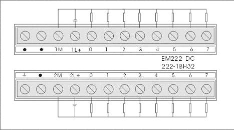

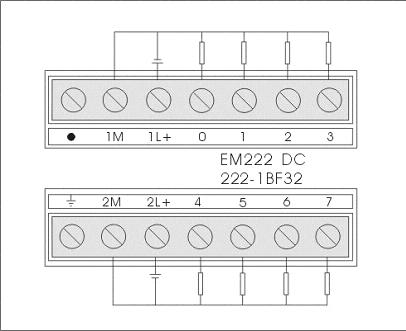

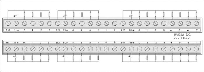

   TrustPLC CTS7-200 EM222¾§Ìå¹ÜÊä³öÄ£¿é£¬8µã
CTS7 222-1BF32
   TrustPLC CTS7-200 EM222¾§Ìå¹ÜÊä³öÄ£¿é£¬16µã
CTS7 222-1BH32
   TrustPLC CTS7-200 EM222¾§Ìå¹ÜÊä³öÄ£¿é£¬32µã
CTS7 222-1BL32
ÐÔÄܲÎÊý
ÌØÐÔ
8µãÊä³ö£¬24V DC
16µãÊä³ö£¬24V DC
32µãÊä³ö£¬24V DC
¶©»õºÅ
CTS7 222-1BF32
CTS7 222-1BH32
CTS7 222-1BL32
ÎïÀíÌØÐÔ
³ß´ç(¿í¡Á¸ß¡ÁÉî)
46¡Á80¡Á62mm
71.2¡Á80¡Á62mm
138¡Á80¡Á62mm
¹¦ºÄ
2W
3W
3W
Êä³öÌØÐÔ¡¡
Êä³öµãÊý
8
16
32
Êä³öÀàÐÍ
¹Ì̬£­MOSFET
Êä³öµçѹ¡¡
    ¶î¶¨¸ºÔصçѹ
    ÔÊÐíµçѹ·¶Î§
    ÐźÅ"1"
    ÐźÅ"0"
24V DC
20.4¡«28.8V DC
×îС20V DC
×î´ó0.1V DC£¨10KÅ·Ä·¸ºÔØ£©
Êä³öµçÁ÷
    ÐźÅ"1"
    Êä³ö×éÊý
    Ã¿×éÊä³öµãÊý
    ͬʱΪONµÄÊä³öµãÊý
    ÿ×é×î´óµçÁ÷
    µÆÔØ
    ½Ó´¥µç×è
    ÿµã©µçÁ÷(×î´ó)
    ÀËÓ¿µçÁ÷£¨×î´ó£©
0.5A
2
4
8
2A
5W
0.3Å·Ä·
10΢°²
8A£¬100ºÁÃë
0.5A
2
8
16
4A
5W
0.3Å·Ä·
10΢°²
8A£¬100ºÁÃë
0.5A
6
4/8
32
2/4A
5W
0.3Å·Ä·
10΢°²
8A£¬100ºÁÃë
¸ôÀë
¹âñî¸ôÀ룬500V AC£¬³ÖÐøÊ±¼ä1·ÖÖÓÒÔÄÚ
    ÿ×é¸ôÀëµãÊý
4µã
8µã
4/8µã
Êä³öÑÓʱ
    ¹Ø£­¿ª
    ¿ª£­¹Ø
×î´ó50΢Ãë
×î´ó200΢Ãë
µçÀ³¤¶È
    ·ÇÆÁ±Î
150 Ã×
    ÆÁ±Î
500 Ã×
+5V DCÏûºÄµçÁ÷
73 mA
56 mA
257 mA
