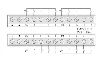

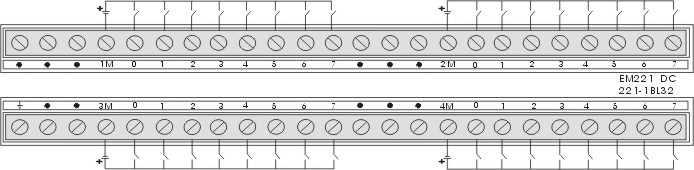

   TrustPLC CTS7-200 EM221Êý×ÖÁ¿ÊäÈëÄ£¿é£¬8µãÊäÈë
CTS7 221-1BF32
   TrustPLC CTS7-200 EM221Êý×ÖÁ¿ÊäÈëÄ£¿é£¬16µãÊäÈë
CTS7 221-1BH32
   TrustPLC CTS7-200 EM221Êý×ÖÁ¿ÊäÈëÄ£¿é£¬32µãÊäÈë
CTS7 221-1BL32
ÐÔÄܲÎÊý
ÌØÐÔ
8µãÊäÈ룬24V DC
16µãÊäÈ룬24V DC
32µãÊäÈ룬24V DC
¶©»õºÅ
CTS7 221-1BF32
CTS7 221-1BH32
CTS7 221-1BL32
ÎïÀíÌØÐÔ
³ß´ç(¿í¡Á¸ß¡ÁÉî)
46¡Á80¡Á62mm
71.2¡Á80¡Á62mm
138¡Á80¡Á62mm
¹¦ºÄ
2W
3W
3W
ÊäÈëÌØÐÔ¡¡
ÊäÈëµãÊý
8
16
32
ÊäÈëÀàÐÍ
©ÐÍ/Ô´ÐÍ
ÊäÈëµçѹ¡¡
     ¶î¶¨Öµ
24V DC
     ×î´óÔÊÐíµçѹ
30V DC
     ÀËÓ¿µçѹ
35V DC£¬ 0.5Ãë
     ÐźÅ"1"
18¡«30V
     ÐźÅ"0"
0¡«5V
¸ôÀë¡¡
    ¹âµç¸ôÀë
500V AC£¬³ÖÐøÊ±¼ä1·ÖÖÓÒÔÄÚ
    ÿ×é¸ôÀëµãÊý
4µã
4µã
8µã
×ÊäÈëʱÑÓ
4.5ºÁÃë
©µçÁ÷
×î´ó1mA  AC
µçÀ³¤¶È
     ·ÇÆÁ±Î
300 Ã×
     ÆÁ±Î
500 Ã×
¿ÉͬʱΪ ON µÄÊäÈëµãÊý¡¡
     40¡æ
8
16
32
     50¡æ
8
16
32
+5V DCÏûºÄµçÁ÷
40 mA
65 mA
111 mA
