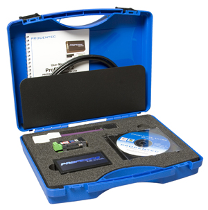

    ÏȽøµÄUSBÓ²ÅÌ-³¬¼¶ProfiCore£¨ProfiCore ULtra£©ÄÚº¬¸ßËÙµÄÊý×Öʾ²¨Æ÷£¬Äܲ¶×½µ½½øÐÐËÙ¶ÈΪ12 MbpsµÄ×ÜÏßÐźţ¬²¢ÄÜͨ¹ýÒ»¸ö³¬¼¶PA̽Õ루PA Probe Ultra£©¶ÔPROFIBUS PAϵͳ½øÐмì²â¡£
Ïêϸ½éÉÜ£º
ProfiTrare2 ¼ò½é
      ProfiTrace 2 ²úÆ·µÄ·¢²¼ÈÃÈËÃǵÄÑÛǰ»íȻһÁÁ£¬Ëü½«ProfibusÐźÅÖÊÁ¿µÄ¼ì²â£¬×ÜÏß¼à¿Ø¹¦ÄܺÍÖ÷Õ¾»î¶¯¼¯³ÉΪһÌ壬ֻʹÓÃͬһ¸öUSBÓ²Å̾ͿÉͬʱ½øÐвÙ×÷¡£¹¤³ÌʦÃÇÖ»Ðèͨ¹ýʹÓÃÒ»¸öÈí¼þ°üºÍÒ»¿éÌå»ýÂÔ´óÓÚÊÖ»úµÄÓ²ÅÌ£¬¾ÍÄÜÔڷdz£¶ÌµÄʱ¼äÄÚ¶ÔÕû¸öÏÖ³¡µÄPROFIBUSϵͳ½øÐмì²âºÍάÐÞ¡£ÕâʹµÃά»¤ÈËÔ±ÔÚ½øÐйÊÕÏÅųýʱ£¬²»±ØÔÙʹÓô«Í³µÄÎ廨°ËÃŵŤ¾ß£¬¼È¼õÇáÁËά»¤ÈËÔ±ËæÉíËù´ø¹¤¾ßµÄÖØÁ¿£¬Ò²¼õÉÙÁ˳ɱ¾¡£ÕâÖÖ³¬Ð¡ÐͱãЯʽ¼¯³É¹¤¾ß´òÆÆÁ˶ÔPROFIBUSϵͳ½øÐм¼Êõ·þÎñ£¬²âÊÔ¼°Î¬»¤µÄ¾ÖÏÞÐÔ£¬¶Ôά»¤£¬µ÷ÊÔ£¬¹ÊÕÏÅųý¼°²úÆ·¿ª·¢ÊÇÒ»¸ö±Ø²»¿ÉÉٵŤ¾ß¡£
      ×î³£¼ûµÄ¹ÊÕÏ:ÈçÔëÒô¡¢Ðźŷ´Éä¡¢µçѹ¼õÈõ¡¢Öն˵ç×衢˫µØÖ·¡¢¶ÏÏߺÍ×é̬´íÎó»áºÜÇáÒ׵ı»¼ø±ð³öÀ´¡£Ê±ÒþʱÏÖµÄÎÊÌâÏñ¹ý³å£¬´íÎó±¨ÎÄ£¬ÖØÊÔºÍÕï¶ÏÒ²¿ÉÒÔ±»²¶×½ºÍÅųý£¬´ÓÕæÕýµÄÒâÒåÉÏʵÏÖÁ˶Ôά»¤ºÍ×ʲú¹ÜÀíµÄ¿ÉÔ¤¼ûÐÔ¡£
ProfiTrare2 ¼¼ÊõÌØµã
Ç¿´ó¹¦ÄܵÄÊý¾Ýͳ¼Æ·ÖÎöÒÇ
Ç¿»¯ProfiTrare 1¹¦ÄÜ£ºÖظ´£¬¶Ï·£¬ÊÜËðÐÅÏ¢£¬Õï¶Ï£¬Ñ­»·ÖÜÆÚµÈ¡£
¸ßËÙÊý×Öʾ²¨Æ÷
ѹ²î£¬AÏߣ¬BÏߣ¬ÔëÒô£¬¹ý³å£¬·´É䣬´¥·¢Æ÷¡£
ÌõÏßͼ
ÿ̨É豸µÄƽ¾ùÖµ£¬×î´óºÍ×îСֵ£¬×ÜÏßÐźÅÖµ¡£
±¨¸æ
×Ô¶¯Éú³É¹¤ÒµÁìÓòÈÏÖªµÄÏêϸ±¨¸æ¡£
DP-V0/V1Ö÷Õ¾
ProfiCaptain¼¯³ÉÁ˸ü¶àµÄÌØÐÔ¡£
ProfiCore Ultra USB½çÃæ
ÓÃÓÚµçÄÔÆ½Ì¨£¬²»ÐèµçԴʡȥ·ÖÖ§Ïß¡£
DPºÍPA
³¬¼¶PAʵÏÖÁ˶ÔPA²¿·Ö½øÐвâÁ¿£¨¼´½«ÍƳö£©¡£
9,6 kbpsµ½ 12 Mbps¡£
ÓÃÓÚ XP ºÍVistaϵͳ¡£
Ó¦ÓÃÁìÓò
1.PROFIBUSÍøÂç¹ÊÕÏÅųýºÍά»¤ (ProfiTrace, ScopeWare and ProfiCaptain)¡£.
2.PROFIBUSÍøÂçµ÷ÊÔ (ProfiTrace, ScopeWare and ProfiCaptain)¡£
3.PROFIBUS ²úÆ·²âÊÔºÍÈÏÖ¤(ProfiTrace, ScopeWare and ProfiCaptain)¡£
4.ÎÞÔ´µçÀ²âÊÔ (ScopeWare and ProfiCaptain)¡£
5.PROFIBUSÉ豸I/O²âÊÔ(ProfiCaptain)¡£
6.PROFIBUSÉ豸µØÖ·ÉèÖÃ(ProfiCaptain)¡£
7.½ÌÓýÅàѵ¡£
