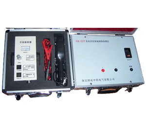

±¾ÒÇÆ÷½á¹¹¼òµ¥¾«ÇÉ¡¢Ð¯´ø·½±ã¡¢¼òµ¥¡¢ÁéÃô¶È¸ß£¬¿É׼ȷ̽²â³ö½ÓµØ¹ÊÕÏÏß·£¬²¢×¼È·¶¨Î»½ÓµØµã¾­ÔÚ¶à¼Ò·¢µç³§¡¢±äµçÕ¾ÖÐʹÓÃÖ¤Ã÷£¬±¾ÒÇÆ÷ÔÚ220V¡¢110V¡¢48V¡¢24V¸÷ÖÖµçѹµÈ¼¶µÄÖ±Á÷ϵͳÖУ¬¾ù¿É׼ȷ̽²â³ö½ÓµØ¹ÊÕϵ㡣

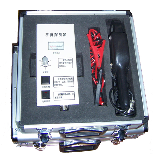

±¾ÒÇÆ÷ÓɱàÂëÆ÷¡¢ÊÖ³Ö̽²â¼°Ì½Í·Èý²¿·Ö×é³É¡£

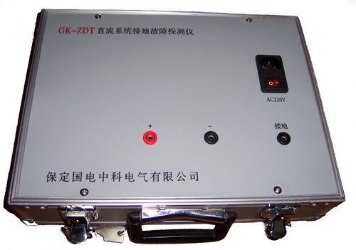

 1.±àÂëÆ÷±àÂëÆ÷ÊDZ¾ÒÇÆ÷µÄ¹Ø¼ü²¿·Ö£¬Ëü°Ñ±àÂëÐźÅ×¢ÈëÖ±ÏßĸÏߣ¬Í¨¹ýÊÖ³Ö̽²âÆ÷½ÓâôÆäÐźţ¬´Ó¶øÅжϹÊÕϵ㡣±¾±àÂëÆ÷¾ßÓÐ×ÔÊÊÓ¦ÐÔ£¬¿É¸ù¾Ý±»²âÖ±Á÷ϵͳµÄʵ¼Ê²ÎÊý£¨ÈçµÈÖµ¶ÔµØµçÈÝ¡¢µÈÖµµçÁ÷¡¢µÈÖµ¸ºÔصȣ©×Ô¶¯Êä³ö±àÂëÐźš££¨±àÂëÆ÷Ëù·¢Á˵ıàÂëÐźŶԼ̵籣»¤Ã»ÓÐÈκÎÓ°Ï죩
 2. ÊÖ³Ö̽²âÆ÷ÊÖ³Ö̽²âÆ÷ÊÇÓë±àÂëÆ÷ÏàÆ¥ÅäµÄ¼ì²âÒÇÆ÷¡£Í¨¹ý̽ͷ½ÓÊÕ¹ÊÕÏÏß·ÉÏÁ÷¶¯µÄÌØ¶¨±àÂëÐźţ¬Í¨¹ý¶Ô̽²âµ½µÄ±àÂëÐźż°ÆäÔÚ´«ÊäÏß·ÉÏËù²úÉúµÄ±ä»¯½øÐзÖÎö£¬´Ó¶øÅжÏÏß·ÖеĽӵص㡣²¢½«½á¹ûʾÓÚ±íÍ·¡£
3.̽ͷ̽ͷÊDZ¾ÒÇÆ÷µÄÐźŽÓâôÓë±äËÍÆ÷¼þ£¬½«Æä¿¨ÓÚ±»²â¹ÊÕÏÏß·£¬¿É½ÓÊÕÏß·ÉϵıàÂëÐźÅ.
