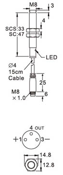

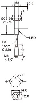

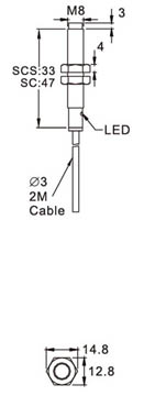

Output mothod 輸出模式 NPN N.O. SC0801-N SC0801-ND SC0802-N SC0802-ND
NPN N.C. SC0801-N2 SC0801-N2D SC0802-N2 SC0802-N2D
PNP N.O. SC0801-P
SC0801-PD SC0802-P
SC0802-PD
PNP N.C. SC0801-P2 SC0801-P2D SC0802-P2 SC0802-P2D
NPN N.O./N.C.
PNP N.O./N.C.
SCR N.O. – – – –
SCR N.C. – – – –
Sensing surface / 檢測方向 Shielded / 隔離型 Unshielded / 非隔離型
Description / 外型 Standard / 標準M8
Standard sensing object / 標準檢測物 Iron 8 × 8 × 1 mm
Sensing distance / 檢出距離 1 mm 2 mm
Secure sensing distance / 建議距離 0 to 0.8 mm 0 to 1.6 mm
Hysteresis / 遲滯 ≦ 10 % of sensing distance
Response time / 反應時間 1 ms Max.
Operating voltage / 工作電壓 DC12 ~ 24 V
Current consumption / 消耗電流 ≦ 8 mA no-load
Load current / 負載電流 100 mA Max
Leakage current / 漏電流 ≦ 1.1 mA no-load
Residual voltage / 殘餘電壓 ≦ DC 1.5V
Insulation resistance / 隔離阻抗 20MΩ min. (DC500V)
Voltage withstandability / 絕緣耐壓 AC1000V 60Hz for 60 Sec.
Operating temperature / 工作溫度範圍 -20℃ ~ + 60℃
Protection degree / 防水等級 IP 66
Wiring method / 出線方式 Pre-wired Ø3 x 2M
/ 3-wires
M8 pigtailed type
/ M8接頭15cm電線式
Pre-wired Ø3 x 2M
/ 3-wires
M8 pigtailed type
/ M8接頭15cm電線式
Weight / 重量 Approx. 30g Approx. 12g Approx. 30g Approx. 12g
