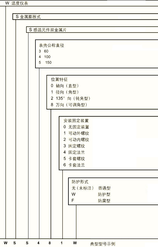

  ¹¤×÷Ô­Àí
Ë«½ðÊôζȼÆÊÇ»ùÓÚÈÆÖÆ³É»·ÐÔÍäÇú×´µÄË«½ðÊôƬ×é³É¡£Ò»¶ËÊÜÈÈÅòÕÍʱ£¬´ø¶¯Ö¸ÕëÐýת£¬¹¤×÷ÒDZí±ãÏÔʾ³öÈȵçÊÆËùÓ¦µÄζÈÖµ¡£
  Ö÷Òª¼¼Êõ²ÎÊý
²úÆ·Ö´Ðбê×¼£º
JB/T8803-1998
GB3836-83
±ê¶ÈÅ̹«³ÆÖ±¾¶£º60¡¢100¡¢150

ÖáÏòÐÍË«½ðÊôζȼÆ
ÐÍ ºÅ ²âη¶Î§¡æ ¾«¶ÈµÈ¼¶ ±£»¤¹Ü²ÄÁÏ ¹æ    ¸ñ °²×°¹Ì¶¨×°ÖÃ
D L
