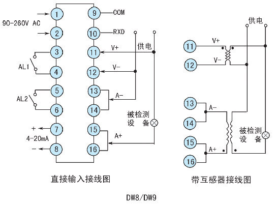

3.¶Ë×ÓÁ¬½Ó
×¢£º½ÓÏßÈçÓб䶯£¬°´³ö³§ÒDZí±íʾ½ÓÏß.

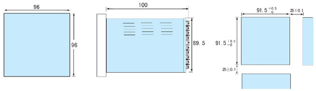

4.°²×°³ß´ç
hspace=0
A
B
L
C
D
DW8
48
96
100
45+0.5
91+0.5
DW9
96
96
100
91+0.5
91+0.5
