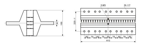

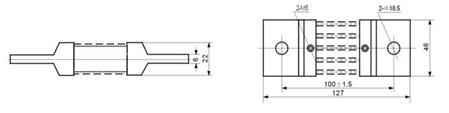

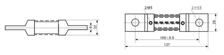

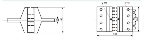

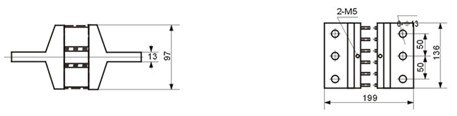

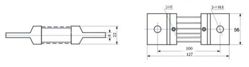

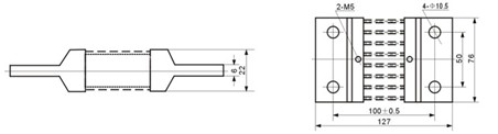

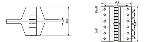

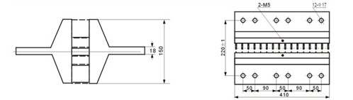

ËÄ£ºÍâ¹Û³ß´çͼ£º
  ²úÆ·ÐͺÅ
                           ²úÆ·°²×°³ß´ç
FL-2£¨1£­50A£©
FL-2£¨100A£©
FL-2£¨200A£©
FL-2£¨300A£©
FL-2£¨400A£©
FL-2£¨500A£©
FL-2£¨600A£©
FL-2£¨750A£©
FL-2£¨1000A£©
FL-2£¨2000A£©
FL-2£¨3000A£©
FL-2£¨5000A£©
FL-2£¨6000A£©
FL-2£¨7500A£©
FL-2£¨10000A£©
FL-2£¨15000A£©
FL-2£¨5000A£©
FL-2£¨6000A£©
FL-2£¨7500A£©
FL-2£¨10000A£©
FL-2£¨15000A£©
