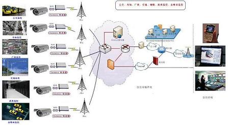

·½°¸Ó¦Óãº
Ò»£¬Ó¦Óð¸Àý
  ÊÓÆµ¼à¿Ø£¨¹«½»¡¢¿¼³¡¡¢³§·¿¡¢½»Í¨¡¢»ú·¿¼à¿Ø¡¢³ö×â³µ¼à¿ØµÈ£©£¨3G·ÓÉÆ÷²úÆ·Ó¦Ó÷½°¸£©
