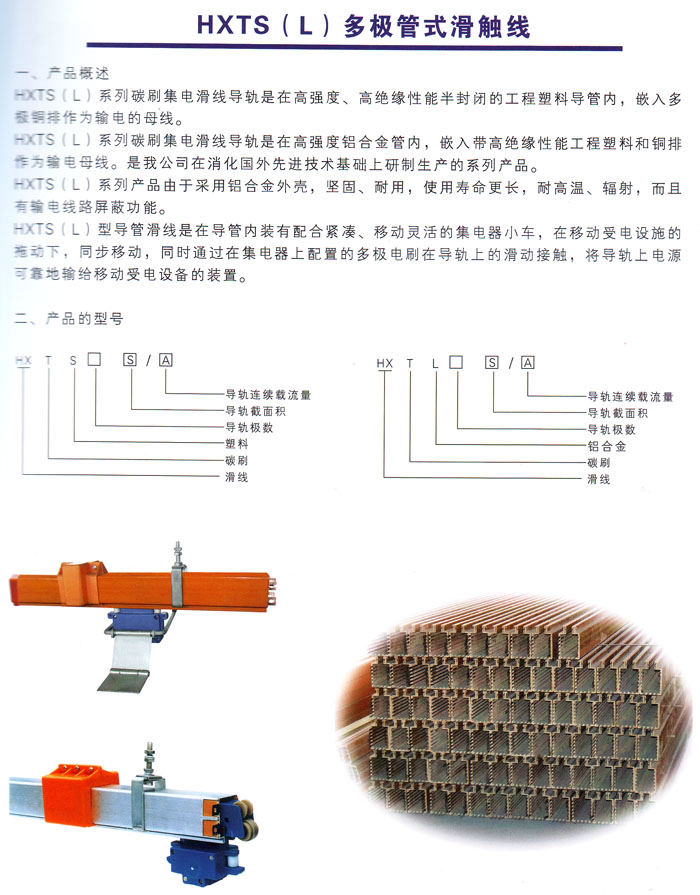

Ò»¡¢²úÆ·¸ÅÊö
HXTS£¨L£©ÏµÁÐ̼ˢ¼¯µç»¬Ïßµ¼¹ìÊÇÔÚ¸ßÇ¿¶È¡¢¸ß¾øÔµÐÔÄܰë·â±ÕµÄ¹¤³ÌËÜÁϵ¼¹ÜÄÚ£¬Ç¶Èë¶à¼«Í­ÅÅ×÷ΪÊäµçµÄĸÏß¡£
HXTS£¨L£©ÏµÁÐ̼ˢ¼¯µç»¬Ïßµ¼¹ìÊÇÔÚ¸ßÇ¿¶ÈÂÁºÏ½ð¹ÜÄÚ£¬Ç¶Èë´ø¸ß¾øÔµÐÔÄܹ¤³ÌËÜÁϺÐÍ­ÅÅ×÷ΪÊäµçĸÏß¡£ÊÇÎÒ¹«Ë¾ÔÚÏû»¯¹úÍâÏȽø¼¼Êõ»ù´¡ÉÏÑÐÖÆÉú²úµÄϵÁвúÆ·¡£
HXTS£¨L£©ÏµÁвúÆ·ÓÉÓÚ²ÉÓÃÂÁºÏ½ðÍâ¿Ç£¬¼á¹Ì¡¢ÄÍÓã¬Ê¹ÓÃÊÙÃü³¤£¬Ä͸ßΡ¢·øÉ䣬¶øÇÒÓÐÊäµçÏß·ÆÁ±Î¹¦ÄÜ¡£
HXTS£¨L£©Ð͵¼¹Ü»¬ÏßÊÇÔÚµ¼¹ÜÄÚ×°ÓÐÅäºÏ½ô´Õ¡¢Òƶ¯Áé»îµÄ¼¯µçÆ÷С³µ£¬ÔÚÒÆ¶¯ÊܵçÉèÊ©µÄÍ϶¯Ï£¬Í¬²½Òƶ¯£¬Í¬Ê±Í¨¹ýÔÚ¼¯µçÆ÷ÉÏÅäÖõĶ༫µçË¢ÔÚµ¼¹ìÉϵϬ¶¯½Ó´¥£¬½«µ¼¹ìÉϵçÔ´¿É¿¿µØÊä¸øÒÆ¶¯ÊܵçÉ豸µÄ×°Öá£HXTS¡¢HXTLϵÁж༫¹Üʽ»¬´¥ÏßÓɸßÇ¿¶È¹¤³ÌËÜÁϾøÔµµ¼¹Ü»òÂÁºÏ½ð±£»¤¿Ç¡¢¶à¼¶µ¼µçÍ­ÅÅ¡¢¼¯µçÆ÷ÒÔ¼°Ðüµõ¡¢¹Ì¶¨µÈ×é¼þ×éºÏ¶ø³É¡£¸Ã²úÆ·ÒÔÆäÉè¼Æ½ô´Õ¡¢ÐÔÄÜÎȶ¨¡¢Ê¹Óð²È«µÄÌØµã±»¹ã·ºµØÓ¦ÓÃÓÚµçÁ÷½ÏС¡¢Ê¹ÓÃÆµÂʽϸߵÄÎïÁ÷×Ô¶¯»¯Á÷Ë®Éú²úÏßÒÔ¼°¼ì²âÏß¡£

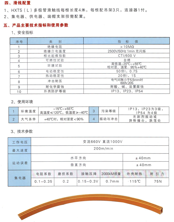

  ÐͺŹæ¸ñ
»¬´¥Ïß½ØÃæ³ß´ç£¨mm)
¼«Êý
ÔØÁ÷Á¿(A)
ÊÊÅäÄÚÖÃС³µÊ½¼¯µçÆ÷
A B C E
HXTS-10 94.0 64.5 17.0 103.0 4-6 50 JD-(4-6)/25
HXTS-15 69.0 62.0 12.5 89.0 80 JD-4/50
HXTS-20 67.0 57.0 17.0 80.0 3-5 100 JD-(3-5)/50
HXTS-35 70.0 62.0 15.0 90.0 4 140 JD-4/50
HXTS-50 67.0 57.0 17.0     80.0 3-6 170 JD-(3-6)/50
HXTS-70 67.0 57.0 17.0 80.0 4-6 210 JD-(4-6)/50
HXTS-96 77.0 77.0 18.0 96.0 3-5 300 JD-(3-5)/100
