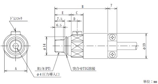

·À»¤µÈ¼¶ IP60 °²×°ÂÝÎÆ R1/8{PT}
ÊäÈë×迹 373.6¦¸¡À5¦¸ Êä³ö×迹 350¦¸¡À5¦¸
ÍâÐγߴ磺
¹æ¸ñ£º
¹æ¸ñ Á¿³Ì A B C D E ¹Ì¶¨ÆµÂÊ(Hz) ÖØÁ¿(g)
PRJ-1MP 1MPa 17 40 9 4.5 12.5 22 45
PRJ-2MP 2MPa 28
PRJ-5MP 5MPa 45
PRJ-10MP 10MPa 19 45 11 5.5 15.5 82 60
