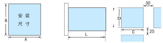

6.°²×°³ß´ç
A
B
L
C
D
DP3
48
96
100
45+0.5
91+0.5
DP3A
48
96
80
45+0.5
91+0.5

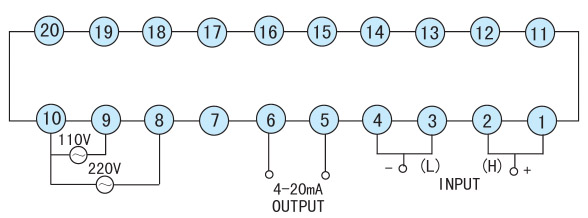

7.¶Ë×Ó°²×°
×¢£º½ÓÏßÈçÓб䶯£¬ÒÔ³ö³§ÒDZí½ÓÏßΪ׼ȷ.
