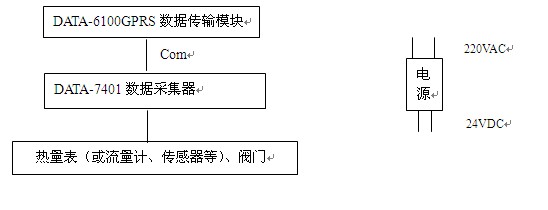

1¡¢DATA-6100 GPRSÊý¾Ý´«ÊäÄ£¿é£º1Ì×
²úÆ·¹¦ÄÜ£º½«´®¿Ú½ÓÊÕµ½µÄÊý×ÖÐźţ¬Í¨¹ýGPRSÍøÂç´«Êäµ½ÖÐÐÄ·þÎñÆ÷ÉÏ¡£
DATA-7401Êý¾Ý²É¼¯Æ÷£º1Ì×
²úÆ·¹¦ÄÜ£º¾ß±¸¶àÏÄÜ£¬ÔÚ±¾ÏµÍ³ÖÐÖ÷Òª²É¼¯´®¿Ú»ò4-20mAÁ÷Á¿ÒDZíµÄ˲ʱÁ÷Á¿£¬×Ô¶¯Éú³ÉÀÛ¼ÆÁ÷Á¿£»²É¼¯Î¶ȡ¢Ñ¹Á¦µÈÊý¾Ý£»Í¬Ê±¾ß±¸8λÊýÂëÏÔʾ£¬¿ÉÏÖ³¡²ì¿´¡£
ÆäËüÅä¼þ£¨¿ª¹ØµçÔ´¡¢¿Õ¿ª¡¢²å×ù¡¢½ÓÏß¶Ë×ӵȣ©£º1Ì×
½ðÊô·À»¤Ï䣺1Ì×
2¡¢ÏÖ³¡É豸ԭÀíʾÒâͼ
