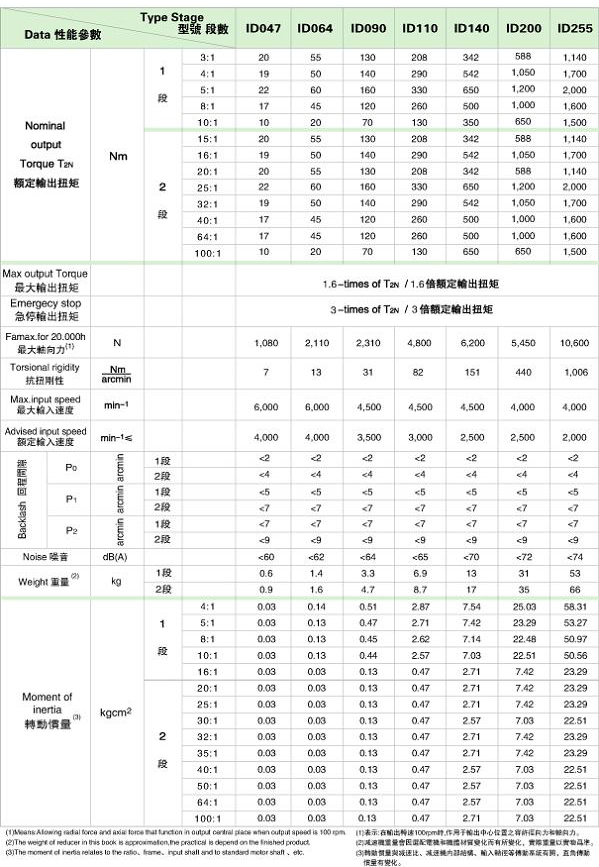

ID precision planetary gear boxes technical data
ID ϵÁо«ÃÜÐÐÐǼõËÙ»ú¼¼Êõ²ÎÊý

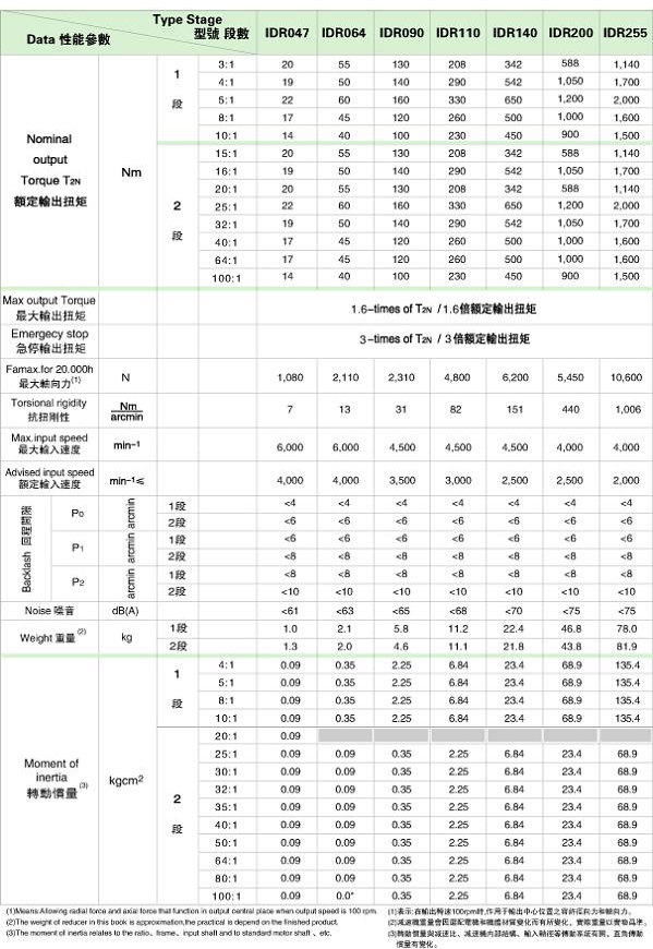

IDR precision planetary gear boxes technical data
IDR ϵÁо«ÃÜÐÐÐǼõËÙ»ú¼¼Êõ²ÎÊý

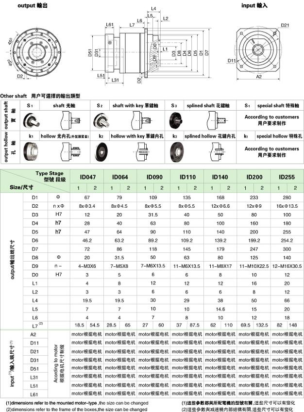

ID motor mounting dimensions
IDµç»úÊäÈëÐÍʽÍâÐΰ²×°³ß´ç

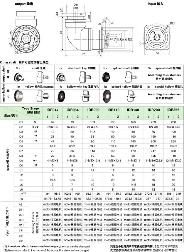

IDR motor mounting dimensions
IDRµç»úÊäÈëÐÍʽÍâÐΰ²×°³ß´ç
