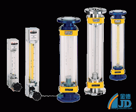

  LZB/LZJϵÁв£Á§×ª×ÓÁ÷Á¿¼Æ¹ã·ºÓ¦ÓÃÓÚ»¯¹¤¡¢Ê¯ÓÍ¡¢ÇṤ¡¢Ò½Ò©¡¢»·±£¡¢Ê³Æ·¼°¼ÆÁ¿²âÊÔ¡¢¿ÆÑ§Ñо¿µÈ²¿ÃÅ£¬²âÁ¿µ¥Ïà·ÇÂö¶¯Á÷Ìå(ÒºÌå»òÆøÌå)µÄÁ÷Á¿¡£
       LZB/( )F/LZJ-( )FϵÁÐÄ͸¯²£Á§×ª×ÓÁ÷Á¿¼ÆÓнÏÇ¿µÄÄ͸¯ÐÔÄÜ£¬¿É¼ì²âËᣨÇâ·úËá³ýÍ⣩¡¢¼î¡¢Ñõ»¯¼ÁºÍÆäËü¸¯Ê´ÐÔµÄÆøÌå»òÒºÌåµÄÁ÷Á¿£¬ÊÊÓÃÓÚ»¯¹¤¡¢ÖÆÒ©¡¢ÔìÖ½¡¢ÎÛË®´¦ÀíµÈÐÐÒµ¡£

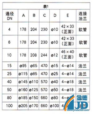

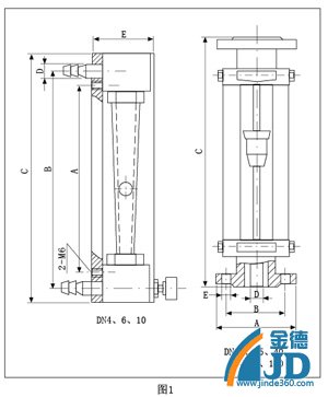

ÍâÐμ°°²×°³ß´ç

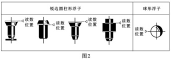

        Á÷Á¿¼ÆÖи¡×Ó¶ÁÊýλÖð´Í¼2Ëùʾ:

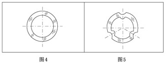

        LZB/LZB-( )FÁ÷Á¿¼ÆµÄ×¶¹ÜΪ¹â»¬ÄÚ±Ú¹Ü(¼ûͼ4)£¬Í¨¾¶DN15ÒÔÉϵÄÁ÷Á¿¼Æ£¬¸¡×Óͨ¹ýµ¼¸Ë     ÉÏÏÂÒÆ¶¯£¬±£³ÖÎȶ¨£»LZJ/LZJ-( )FÁ÷Á¿¼Æ×¶¹Ü    ÄÚ±ÚÓÐÈýÌõµ¼Ïò͹½î£¬Ê¹¸¡×Ó±£³ÖÎȶ¨(¼ûͼ4)¡£  ͨ¾¶DN10ÒÔϵÄÁ÷Á¿¼Æ²ÉÓÃÈí¹ÜÁ¬½Ó£¬ÅäÓР    ÕëÐÎÁ÷Á¿µ÷½Ú·§£»Í¨¾¶DN15ÒÔÉÏÁ÷Á¿¼Æ²ÉÓà   ·¨À¼Á¬½Ó¡£

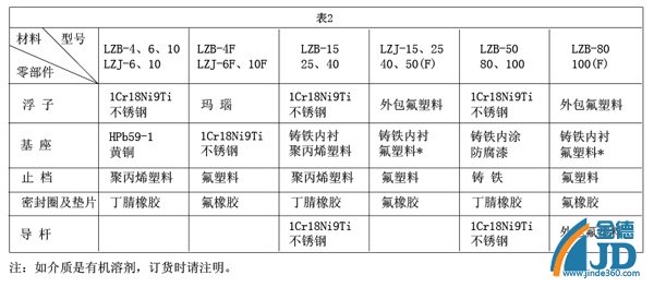

½Ó´¥²âÁ¿Á÷ÌåµÄÁ㲿¼þ²ÄÖÊ

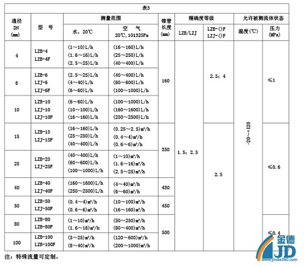

ÐͺŹæ¸ñ¼°¼¼Êõ²ÎÊý
È«²»Ðâ¸ÖÐÍ
        ·¨À¼¡¢¸¡×Ó¡¢µ¼¸Ë¡¢Ö§³Ð°å¼°ÂÝ˨µÈ¾ùΪ²»Ðâ¸Ö304£¨1Cr18Ni9Ti),ÐͺÅΪLZB-( )B¡£
        ½ÓÒº²ÄÖÊÈçÐèÑ¡ÓÃ316£¬ÔòÐͺÅΪLZB-( )Bo£¬Ð趨×ö¡£
        ÈçÐè²»Ðâ¸ÖÄÚ³ÄPTFE£¬ÔòÐͺÅΪLZB-( )BF(»òBoF),Ð趨×ö¡£
 È«ËÄ·úÐÍ
        »ù×ù¡¢¸¡×Ó¡¢Õë·§²ÉÓþÛËÄ·úÒÒÏ©£¨PTTFE)¡£Ö§³Ð°å¡¢ÂÝË¿µÈ²ÉÓò»Ðâ¸Ö
