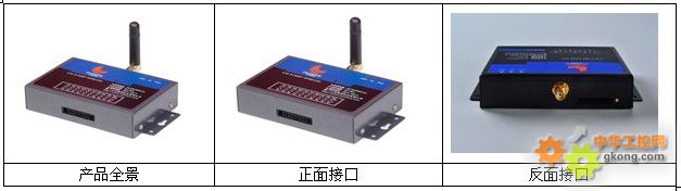

CM3160P²úÆ·½Ó¿Úͼ£º

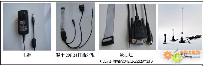

CM3160P²úÆ·Åä¼þͼƬ£º
CM3160EP²úÆ·½Ó¿Úͼ£º
CM3160EP²úÆ·Åä¼þͼƬ£º

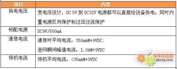

6.    ¹¤Òµ¼¶µçÔ´£º¿íѹµçÔ´Éè¼Æ£¬µçÔ´ÊÊÓ¦·¶Î§ÎªDC5V~DC35V£¬ÄÚÖõçÔ´·´Ïò±£»¤ºÍ¹ýѹ¹ýÁ÷±£»¤¡£

13.  µÍ¹¦ºÄÉè¼Æ£ºÐÝÃß¹¦ºÄ<1mA£¬´ý»ú¹¦ºÄ<15mA£¬Í¨ÐʦºÄ<35mA

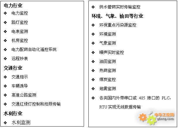

ËÄ¡¢²úÆ·Ó¦ÓÃÁ´½Óͼ

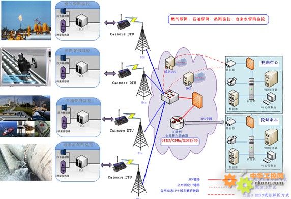

1¡¢  ¼ì²âÐÐÒµÓ¦Óã¨ÎÛȾ¡¢ÆøÏó¡¢Ë®ÎÆ¡¢Ë®Àû¡¢µØÕðµÈ£©
2¡¢  Íø¹Ü¼à¿ØÐÐÒµÓ¦Óã¨È¼Æø¹ÜÍø¡¢Ê¯Ó͹ÜÍø¡¢ÈÈÍø¼à¿Ø¡¢×ÔÀ´Ë®¹ÜÍø¼à¿ØµÈ£©
3.  ÓÍÌï¼à¿Ø¡¢Â·µÆ¿ØÖÆ¡¢½»Í¨¿ØÖÆ¡¢³µÁ¾ÓÕµ¼

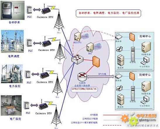

4.µçÁ¦ÐÐÒµÓ¦Óð¸Àý£¨Åäµç¼à¿Ø¡¢µçÍø×Ô¶¯»¯¡¢×Ô¶¯³­±í¡¢µçÍøµ÷¶È£©
