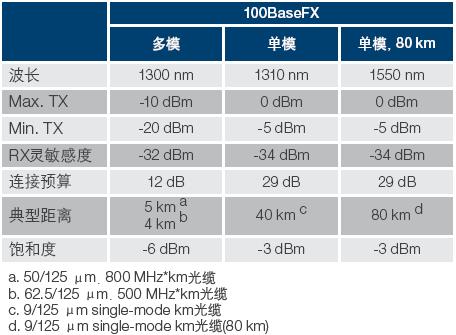

¿ìËÙÒÔÌ«Íø½Ó¿ÚÄ£¿é£¬IMϵÁÐ
½Ó¿Ú ¹â¿Ú£º100BaseFX¶Ë¿Ú(SC/ST½ÓÍ·)
RJ45¶Ë¿Ú£º10/100BaseT(X)×Ô¶¯ÊÊÓ¦£¬°ëË«¹¤/ȫ˫¹¤£¬MDI/
MDI-X×Ô¶¯Õì²â
LEDָʾµÆ£ºPWR£¬P1£¬P2£¬P3£¬P4¶Ë¿Ú״̬
¹âÇ¥
µçÔ´ ¹¦ºÄ(@ 24 V)£º
IM-4TX£º1.52 W
IM-2MSC/2TX£º2.43 W
IM-2MST/2TX£º2.43 W
IM-2SSC/2TX£º2.43 W
IM-1LSC/3TX£º2.5 W
IM-4MSC£º6.6 W
IM-4MST£º6.6 W
IM-4SSC£º6.6 W
»úÐµÌØÐÔ Íâ¿Ç£ºIP30·À»¤
³ß´ç£º40 x 127.8 x 100 mm (1.57 x 5.03 x 3.94 in)
ÖØÁ¿£º
IM-4TX£º215 g
IM-2MSC/2TX£º245 g
IM-2MST/2TX£º250 g
IM-2SSC/2TX£º245 g
IM-1LSC/3TX£º235 g
IM-4MSC£º250 g
IM-4MST£º270 g
IM-4SSC£º270 g
MTBF£¨Æ½¾ùÎÞ¹ÊÕÏʱ¼ä£©£º ʱ¼ä£º620,000 Сʱ
Êý¾Ý¿â£ºMIL-HDBK-217F£¬GB 25 ¡ãC
